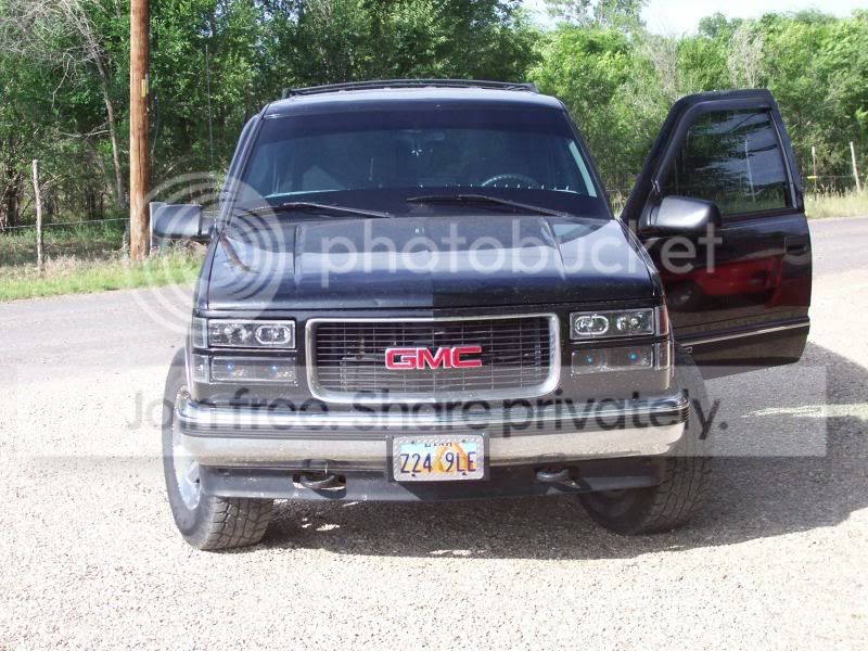

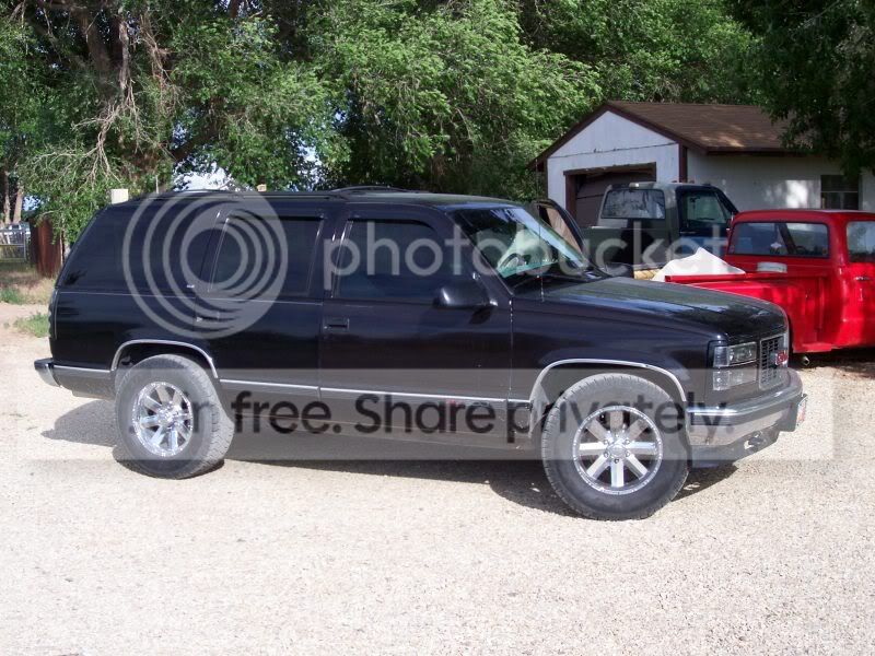

Front doors (20%) and windsheld strips (top is 5% bottom is solid non transparent) on my yukon the rest of the tint is factory.
