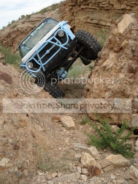

Soooo I figured after 16 years of wrenching on the truck and 13 yrs of being a part of this forum (off and on, mostly off.) I should document my build.
This will be an ongoing thread as I dont think I will ever stop messing with it. What we have here today is
1974 Chevy Blazer (full vert)
Frame boxed completly from front to rear (unfortunately no pics) Full cage to frame in 8 points all .120HREW
Checker's special sb 350 with typical bolt ons. (intake, Shorty headers,
Mild RV cam (forgot specs but have them in file folder) Q-Jet for now.
TH400, 1st gear lockout, mildly built, some fancy TC because I killed the splines trying to get a STaK case to pop out of gear (more on that later)
STaK 3 spd monster box with 5.44 low.
Front Dana 60. 4.56. Lock-rite. Yukon 35 spline outers, stock inners. Spicer joints. ORD Crossover. WTO Hydro Asst. .250 tierod. Warn hubs (street) STaK Drive slugs (fun)
Rear 14 bolt Van axle (bent) 4.56. Welded. pretty much stock. RuffStuff specialties traction bar
Driveshafts are JE Reel. .180 ft/re 1410(case)/1350(axle) rear with extended travel spline (dont know but can check) front is a 1350 BAMF (case)/1350 (axle) also extended spline.
Ford F150 rear springs in the rear (57") inboarded on RuffStuff Specialties mounting hardware. Bilstein 5100 14" travel shocks
Chevy k10 Suburban rear springs in front (56") on Hill Extended shackles in stock location, custom from mount. Sway-A-Way 2.0 14" travel emulsion (coilover ready)
39.5x13.5x17 Iroks mounted on Raceline Monster Beadlocks. (no wheeling pic..part of V3.1) In the pics you will se H2 wheels (HATED these wheels)
Last wheeling trip about 3 yrs ago
