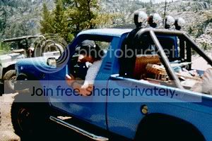

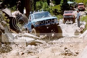

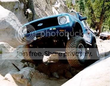

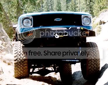

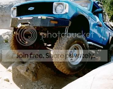

here is some inspiration for ya
http://www.pirate4x4.com/forum/chevy/993842-whole-lotta-luv.html
That's pretty freaking sweet! Maybe a little more work then I would want. Just a tad...
