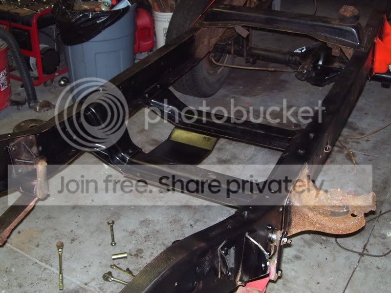

Since I realized the frame rails go straight back instead of flaring out like the newer frames do, and the rear cab mounts are pretty identical to a standard truck frame, I thought why not put the C20 cab/clip on it instead and use it as my new playtoy.
So, with a '74 frame and an '80 cab, everything should be a bolt on, right? No fabbing a rear mount, right? I don't want to get everything off and ready to go on the frame and find out I have to do mod work unless I know ahead of time.
Any thoughts or suggestions?
Yes it will bolt right up...
as long ast yuo have the crossmember in the very back of this picture.

Yep! Mine looks exactly like yours. I'm even doing the double crossmember and skidplate, too. I just installed 6" Skyjacker front springs today. Gonna wait til I get the 454/465/205 on the K30 frame sold so I can swap the D60 under this frame. The 14FF is coming out of the C20 I'm robbing the cab for.

thats nice.OR you can make your own.it sits right on the k5 mounts.
