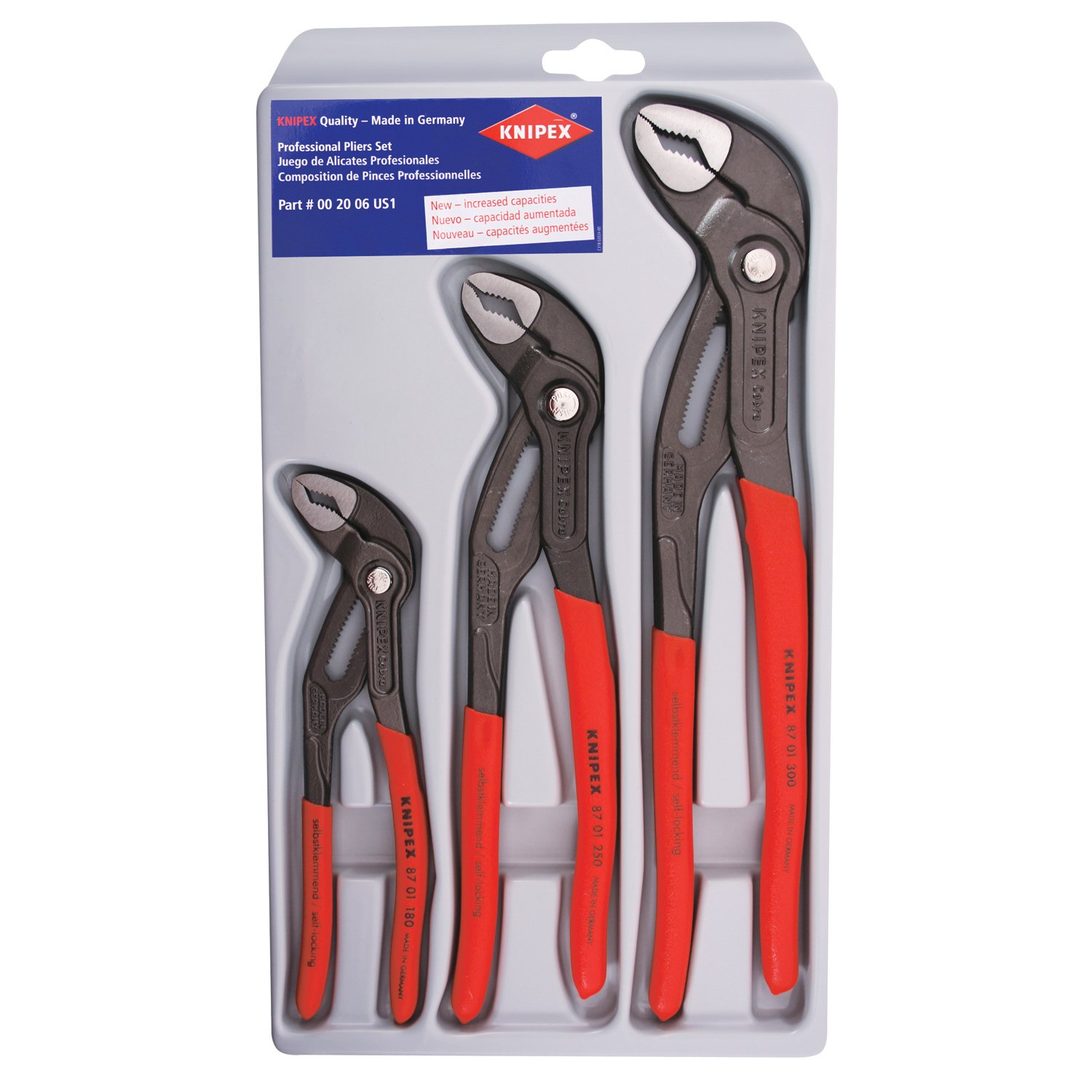

For future usage buy yourself a set of these. They grip like a pipe wrench and dig in. They work for pipe fittings, studs, broken bolts, all kinds of things. They ain't cheap but they are worth it. I think the small pair in this 3 plier set would probably grab things like that screw possibly. These are 1000 times better at gripping than a vice grip. https://www.amazon.com/KNIPEX-Tools...s=cobra+pliers+set&qid=1568905986&s=hi&sr=1-3
