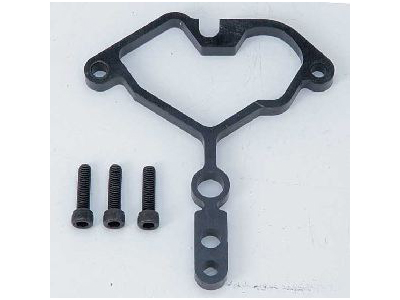

Here is what the injector pod spacer is and does. http://marine-performance-parts.com/cfmtechinjectorspacerforgmtbi435057.aspx

The spacer pictured above are stock to 454 Throttle Bodies. The parts stores should have them / can get them? Heck I guess it's possbile to sandwhich two 350 throttle body gaskets to make the same thickness as the 454 gasket / spacer?
dave w
Dave is correct about this being stock on 454 TBI units. I had one on my 350 TBI and when I swapped to the 454 TBI I noticed it was the same thickness but I added the extra spacer as well and just came up with even longer bolts. :D

I'll be ordering the pod spacer today. It should help HP, which is always good I guess, but it's super cheap anyway so why not.
