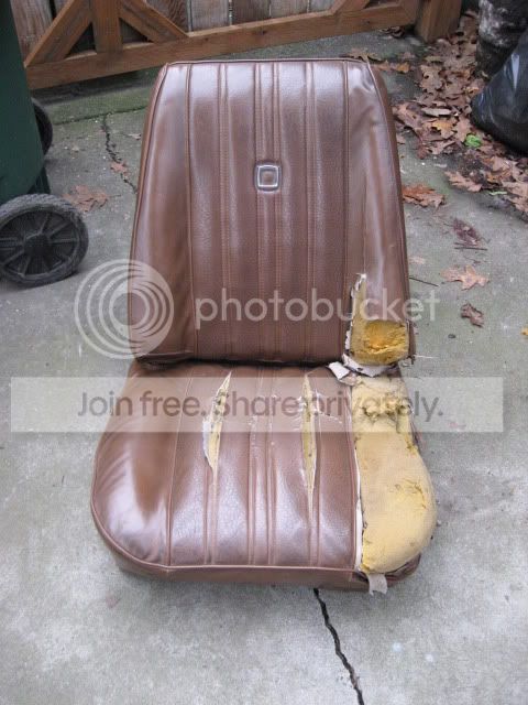

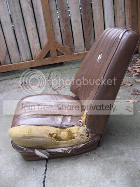

Well, here we are, four plus months later, and I finally decided to get the driver's side seat replaced. You can see that the original is pretty much hashed...
and leaning back like a Lazy Boy recliner...
and yes, it was pretty much impossible to drive with it.

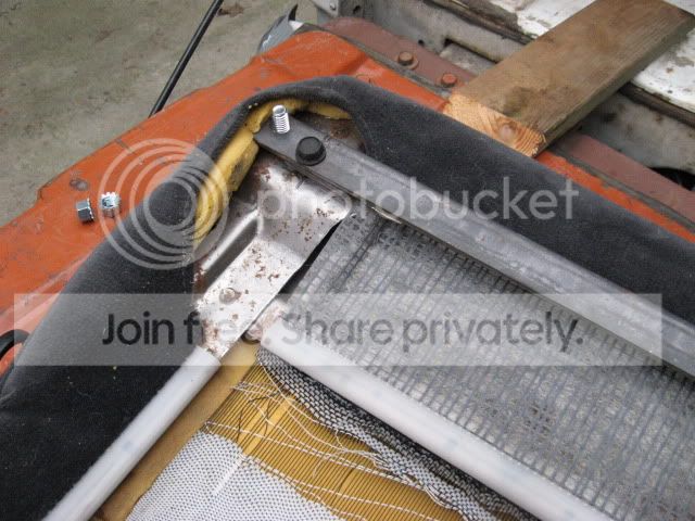

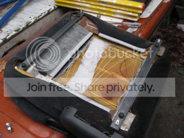

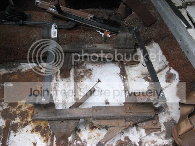

Per the suggestions given previously, I decided to use the stock seat mounting brackets instead of fabbing up my own. I unbolted the driver's side seat from the floor, unbolted the seat brackets from the seat, and put the seat brackets back in the truck. Then, with a little measuring, I realized I needed just a few inches of metal on each side to give the new seat something to bolt to. I had some 1/4" x 1 1/2" strip sitting around, so I drilled some holes and mocked the new strip brackets up in place. I was going to cut some individual brackets and weld them to the original seat brackets, but I had a bunch of the strip around, and I liked how it tied the two sides together, so I went with it.
The new seat is slightly shorter front-to-back, so I used the rear-most mounting holes in the original seat bracket. Believe it or not, they lined right up. Blind luck, but I'll take it.
I bolted the strip brackets to the seat bottoms.
The black bolts are the ones that came on the new seats (they held the tracks on). The silver bolt is the one that will attach it to the old seat bracket, in the existing holes.

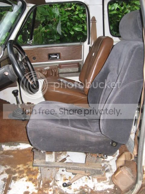

Then I just put the seat in place, and bolted it in. Easy.
The difference is night and day. The new seat is a little narrower, but the support is good, and I'm sitting about 2" higher than I was previously (that's how sacked out the old seat was). As an added bonus, the new seat reclines fully, and has an adjustable headrest. Seatbelts works as they should, the adjuster works fine (actually had to move the seat back a click) and the center console fits perfectly.
This took me all of 2 hours, most of it spent measuring twice for the location of the bolt holes. Everything is bolted together right now (the bolts that hold the strip bracket to the bottom seat bracket are some 3/8" Grade 5 stuff I had sitting around) but for safety's sake, I'm going to weld the strip brackets to the bottom of the seat pan, and replace the Grade 5 bolts with some Grade 8 hardware, installed with some Loctite and some large washers. This means that I can unbolt the seat from the original seat brackets and replace it with a stock seat if I ever care to do so (or if I ever find one in decent shape).
