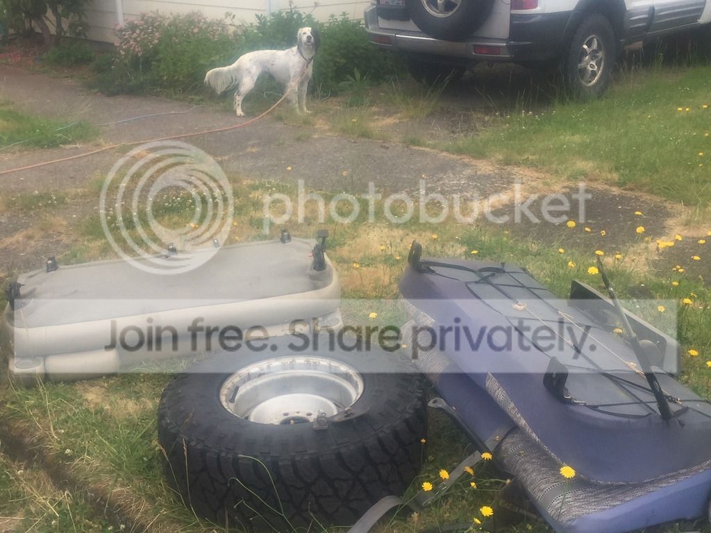

The 2 seats.

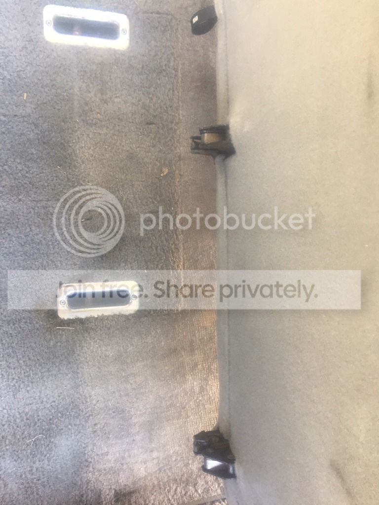

New seat not lining up :(.

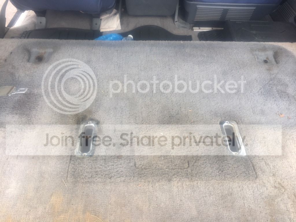

Brackets in truck once old seat was removed.

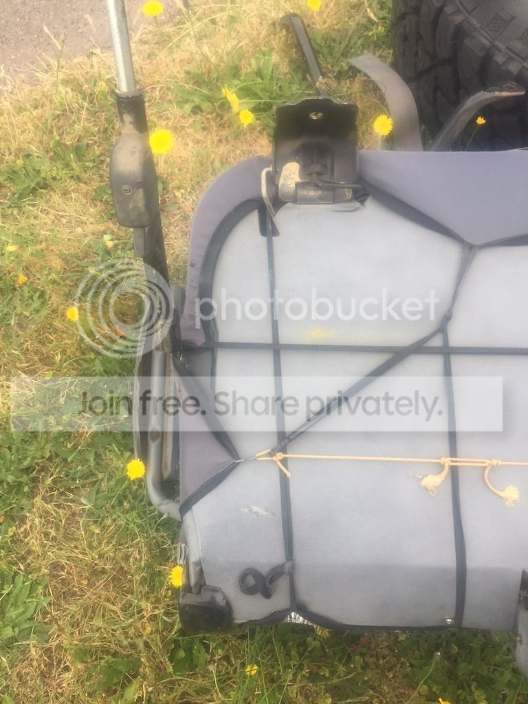

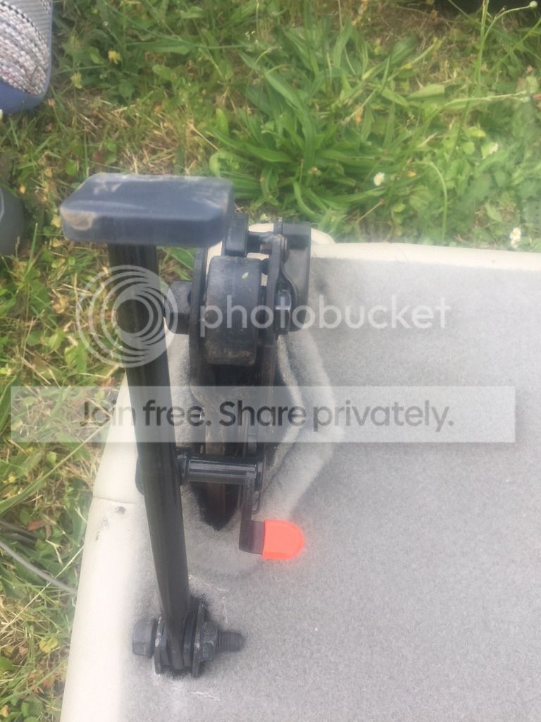

New seat with the strut.
Old seat with strut.

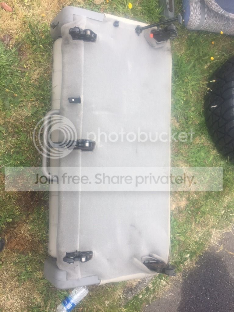

New seat close up of hooks.
