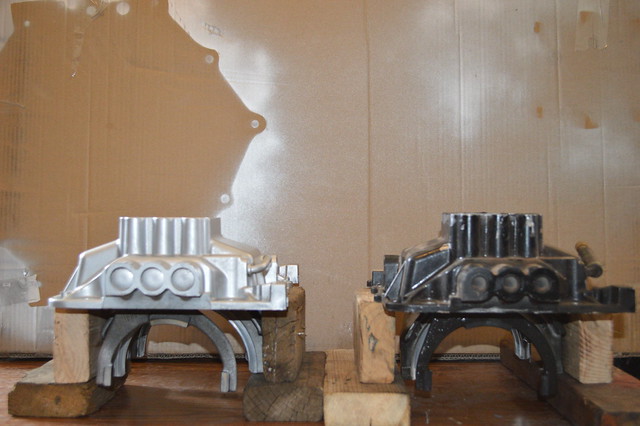

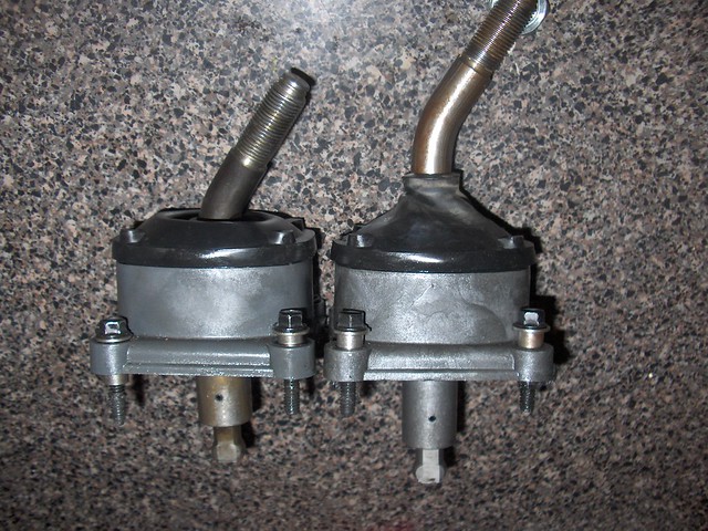

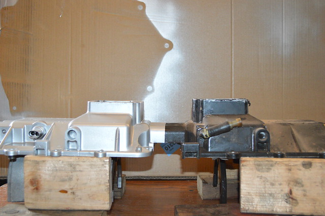

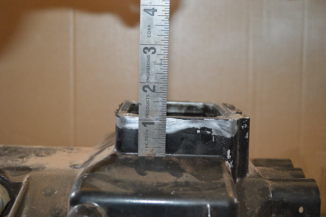

I have not seen any pictures to compare the standard and HD truck shift covers and shift towers before so here ya’ll go! Hope it helps someone down the road. BTW…..If anybody is interested in the taller HD truck shift cover and shift tower let me know. $200 takes it, including the ride. Probably work pretty well for those running a body lift. It only has about 20,000 miles on it and even the shift pads look like brand new still.

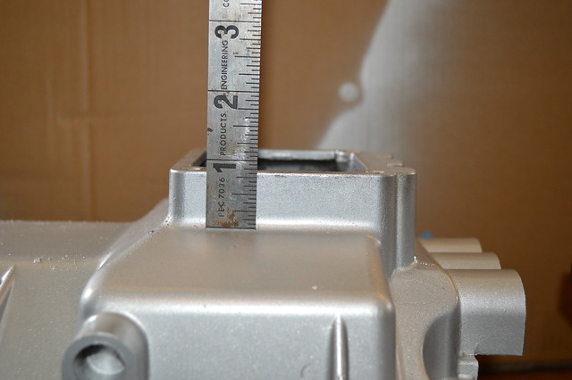

1995-?? Low shift tower on the left / 2001 – 2006 HD truck shift tower on right
2001 – 2006 2500HD/3500 truck shift tower Over ¼” difference!
Low shift cover on left / tall on right. Hard to eyeball the height difference from this angle
A little easier to notice the difference in this pic

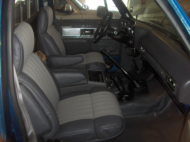

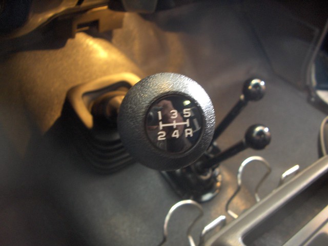

I sure like the shifter stick location and geometry much better now with the shorter cover and tower
The shifter is back in the location it was back in 2010
I didn't take any pics of the shift lever with the HD truck bits and pieces but the lever was way up high and even with the steering wheel. I like it much better now back in the lower location!
