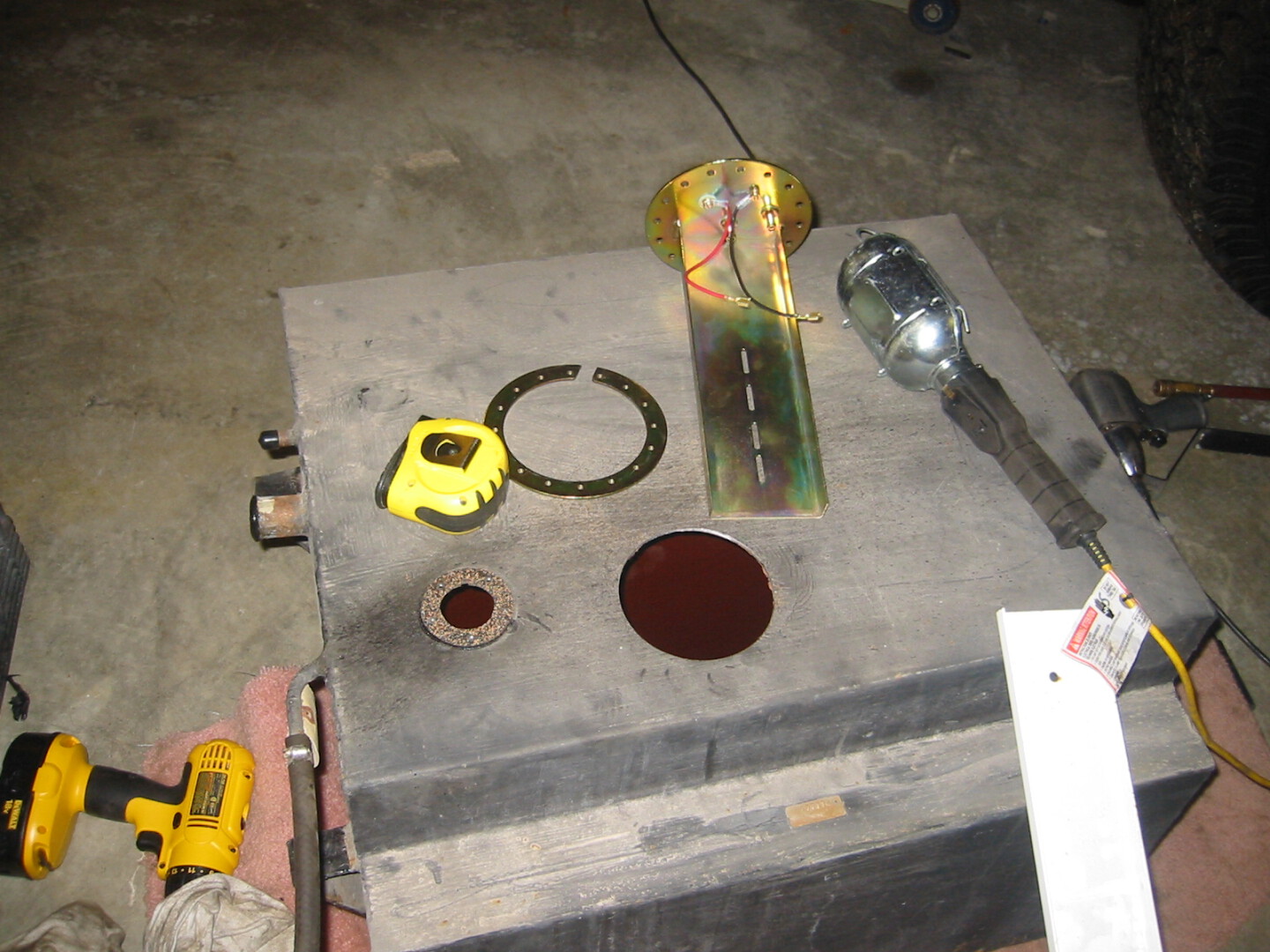

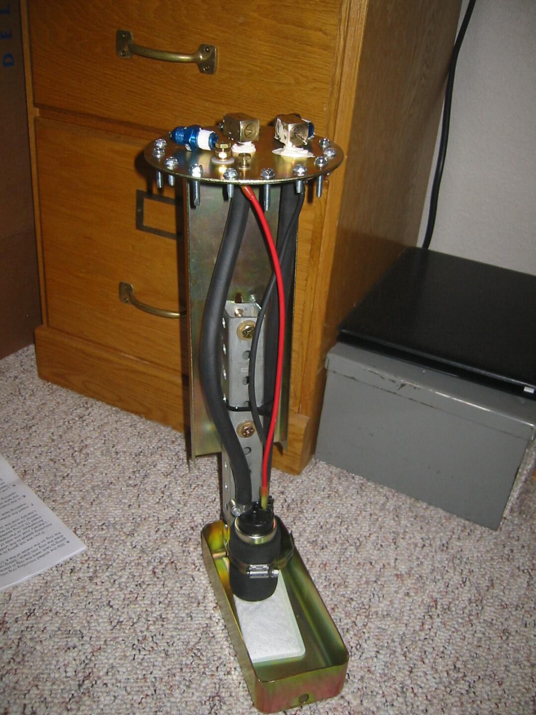

I needed to do this for my RamJet350 install. It's port fuel injection, requires baffled tank and is port fuel injection system.
I started with a tanksinc setup (click it, it will go to their website):
And modified it for the extra deep 40 gal Hickey tank I have, that has some rudementray baffles in it (one, IIRC). The little bowl on the bottom, I feel, helps tremendously with holding fuel for angles and off-roading and I feel really helps compliment baffles or even compensate for lack of baffles.

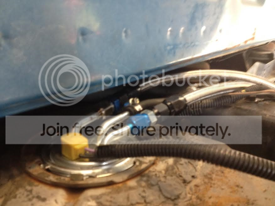

And for those who will be using saddle tanks on a TBI truck (not the blazer/suburban TBI tank), these do not have the threaded end fittings on the sending unit as pictured above. They just have the normal ports to slip a rubber hose and hose clamp on just like carb'd trucks. In this case, you just order these tube sleeve and nuts:
https://www.summitracing.com/parts/EAR-581805ERL
https://www.summitracing.com/parts/EAR-581905ERL
https://www.summitracing.com/parts/RUS-660571
https://www.summitracing.com/parts/RUS-660651
Along with these adapters:
https://www.summitracing.com/parts/AER-FBM2755
https://www.summitracing.com/parts/EAR-981506ERL
Then you need to cut the ends off the feed and return line ports on the sending unit, put the nut and sleeve's on there, and then flair the lines...it will look similar to below:
With the adapters on:
And in the tank with brand new -6AN hose and hose ends hooked up to it:
As a word of caution, it's worth trying to find a sending unit if going this route that has longer ports on it then most normal sending units. I ended up finding this sending unit off RockAuto that worked really good:
http://www.rockauto.com/en/moreinfo.php?pk=972608&cc=1061895&jsn=13
You will notice how much longer the ports are than normal sending units you find at parts stores. When I used a normal sending unit (pictured above) the only way to get the flairing tool on there was to bend the ports straight up, flair it, then bend the ports back down...but in doing this is cause a small crack in the tube at the bend which leaked....when I used this new sending unit with the longer ports, I didn't have to bend them at all and everything went smooth (and yes I've tested this new sending unit and it works like a charm :))
I know this is not what the OP is asking, but knowledge is power in this game, haha
