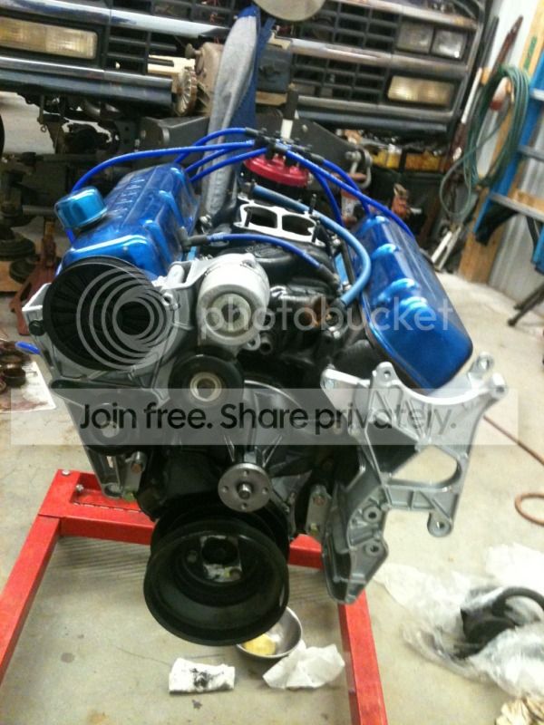

Fwiw, here's a pic of mine. I like it because it's all nice and tight instad of being spread out huge like a real bbc set up.

Thanks for the pic,I was just about to ask you for one. Where did you get the AC delete pulley?
The A/C delete pulley is from Autozone or O'Reillys (can't remember). It's nothing special, just a run of the mill delete pulley for a serpentine application.
