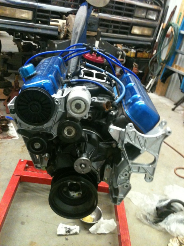

Searched, lots of results nothing on the head. Can I slap a serpentine setup from a 92-98 body 454 truck on the front of the 454 in my 91 r3500?
Should be able to.
Maken sure you get the crank & water pump pulleys. Be aware you will need a reverse flow water pump also.
full
I had the kwik kit on a 454 I put in my old 79 Malibu. Tucks everything in close. Can't imagine the price of em now tho!!! They were $50 I think when I bought mine, last I checked over $100.
Unless I'm reading the first post wrong, he's switching from a 454 to a 454? I've used the kwik adapter Brackets, they work great, but are for a 350 bracket system on a 454. I can't say much about swapping different big block bracket systems and whether or not they are interchangable. I can tell you the kwik brackets are $163 now, plus the cost of the sbc brackets if you don't have any laying around.
The A/C compressor will be different, alternator should be the same, not sure bout P/S. If have all the parts off the donor should bolt on.
