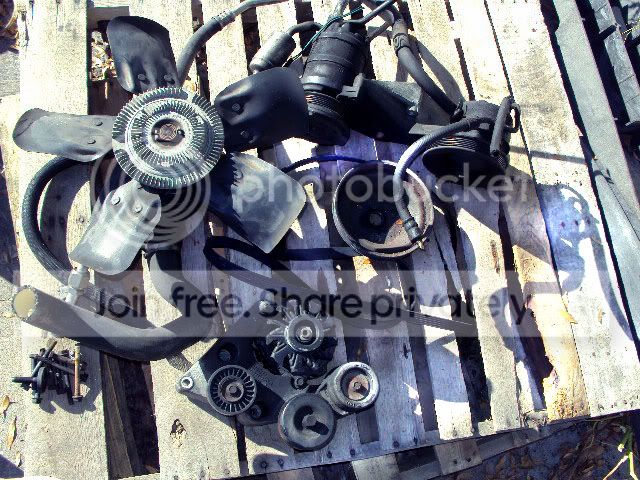

Serpentine System... is this a good deal?

He wants $120+shipping
Does it have everything I need? In my 1985 K5 I have a 70's 400 SBC. Would these parts work for me?
The serpentine assembly includes AC compressor, PS pump, water pump, alternator, clutch and clutch fan, all pulleys, all brackets, all bolts, serpentine belt and some hoses are still attached.
im not sure in what you need...
but look under your hood.. look at what is there.. and see if it makes sense...
i never did the serp route... i like having multiple belts.... something bout having one belt and wheeling..... if a snap there goes it all... power steering, water pump, etc... :dunno:
Those don't look like the typical 88-95 truck SBC brackets... they almost look like a car or a later truck/van setup. If you do get it, tell them to trash the w/p. You should replace that anyway, you'll spend more on shipping it than you would buying a new/reman one. If the deal falls through.... I have most of t'he stuff off my 91 k5 I wont be using.
I would search for an aluminum setup...90-95's SBC or 4.3 work well. I have spare belts if you need one. I went BBC, so the SBC belts are too short.
