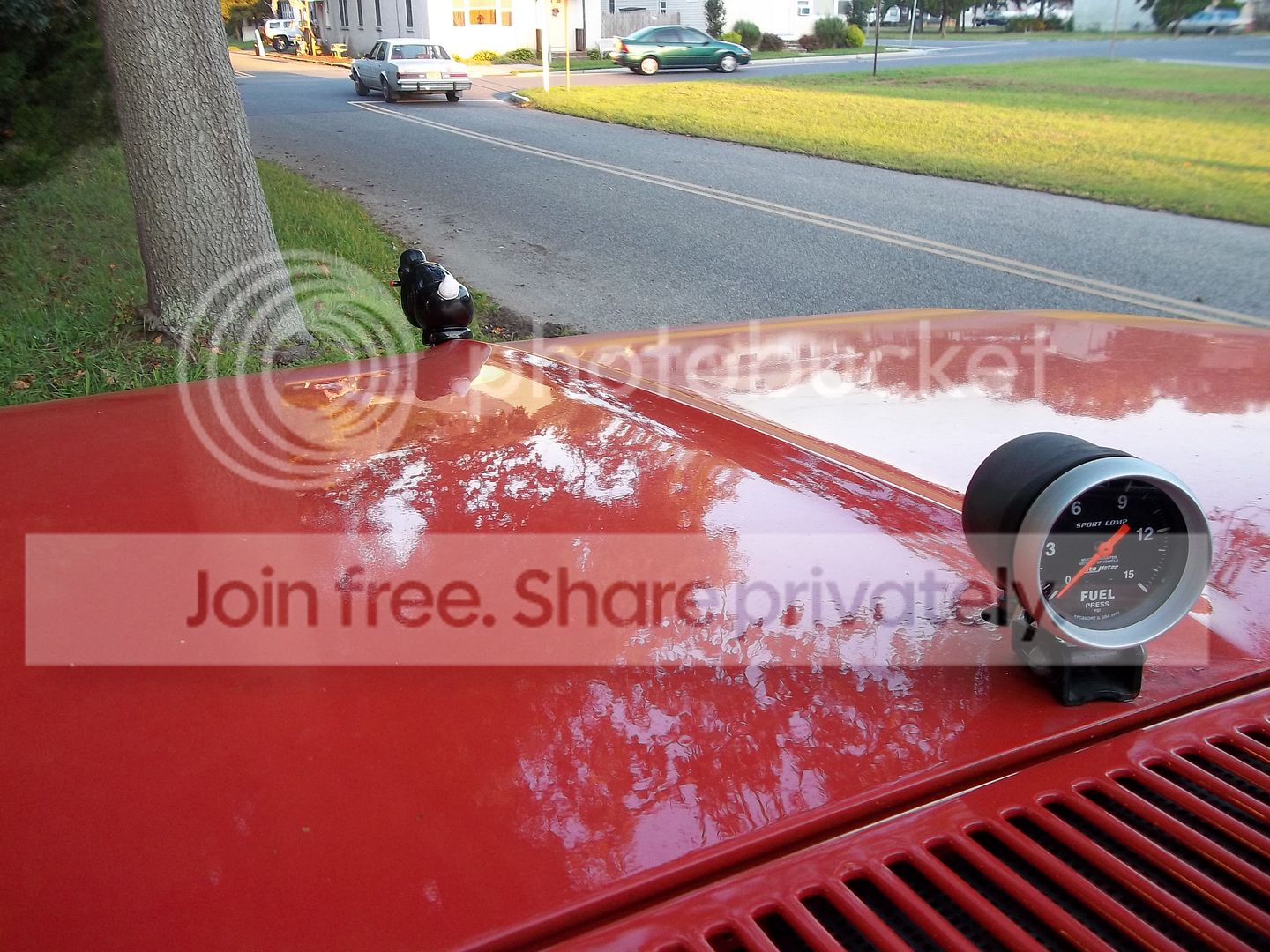

yes, you can leave the gauge in, most do... I run an Autometer out on the hood for "while driving monitoring", plumbed into the CFM adapter...
and I also run a Walbro 255 out of the early 90's TPI maro's... 14 psi rock steady... about $125....

Opinion: running a fuel pressure gauge all the time is pointless and unnecessary. Borrow the autozone tool, hook it up *at the end of the braided hose from the engine near the frame rail* but you aren't going to be able to test it running, and someone will have to watch the gauge as you step on the throttle, the hose isn't long enough to reach anywhere you can see it. You will get drenched with fuel unfortunately, due to the design the fuel line will siphon from the tank while you are disconnecting the line and connecting the fitting for the gauge.
