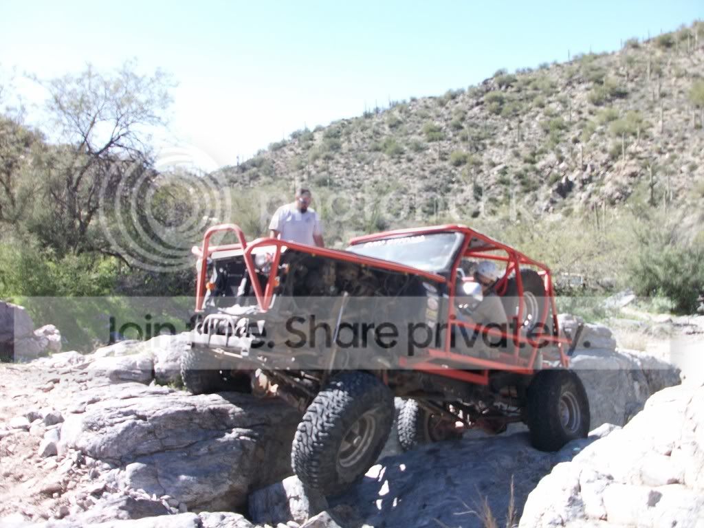

I don't see why it wouldn't hold up mudding . Several guys have welded drop brackets for the front frame section to get more lift . And they go rockcrawling . One even used a whole section of rectangle tube that doubles as a winch mount .
Its all in the welding though , clean clean clean clean the parts of any paint and oils , and get good penetration .
Heres a shot of jason4x4's rig where you see the rectangle tube that drops the front hangers down and mounts his winch
