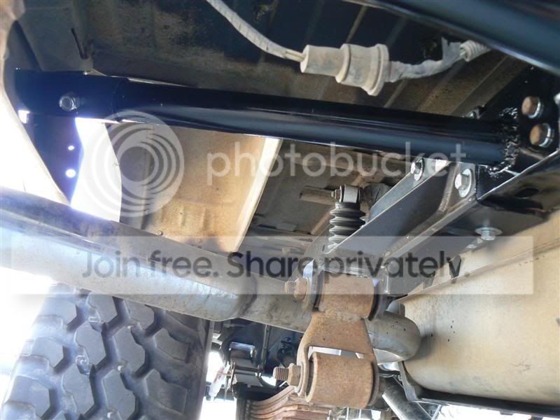

I can get you some. I have 5" usdr with a skye flip. All the pics are at home I will try to post up tonight.

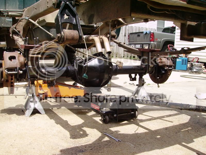

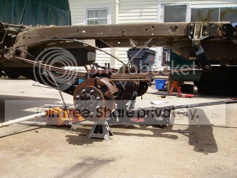

Here are mine. There are a bunch in the build link in my sig of them. I am at work right now so i cant access my photobucket. These are the 7" BTW.
I'll take a look at your build thread too. I am hoping for some close up pics of the shackle and flip if there is one. Thanks guys.
