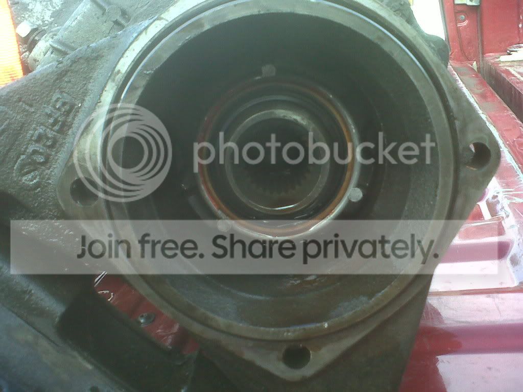

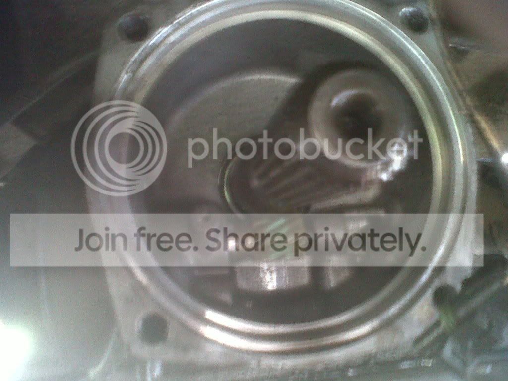

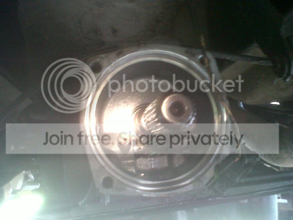

Well, I'm more confused. Pull the tcase, and the seal looks fine, and there was no ATF in between it and the tranny. The seal around the tcase input doesn't look great, but the output from the tranny looks fine. Losing fluid from both though, and no idea why it would be hitting pressures like that...
tcase input
tranny output
Sorry, the tranny ones are a little blurry...
