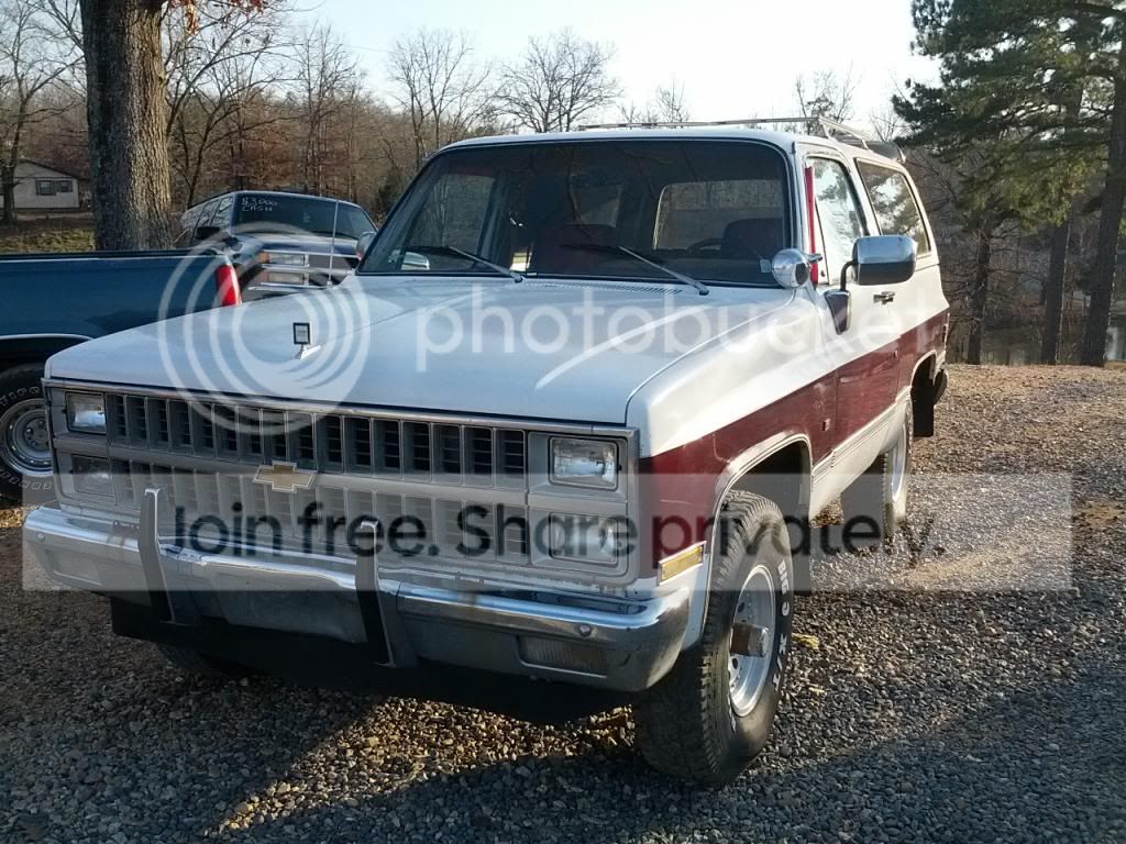

The day I bought it. I remember someone here said I had a nice Bronco :flipoff7: lol

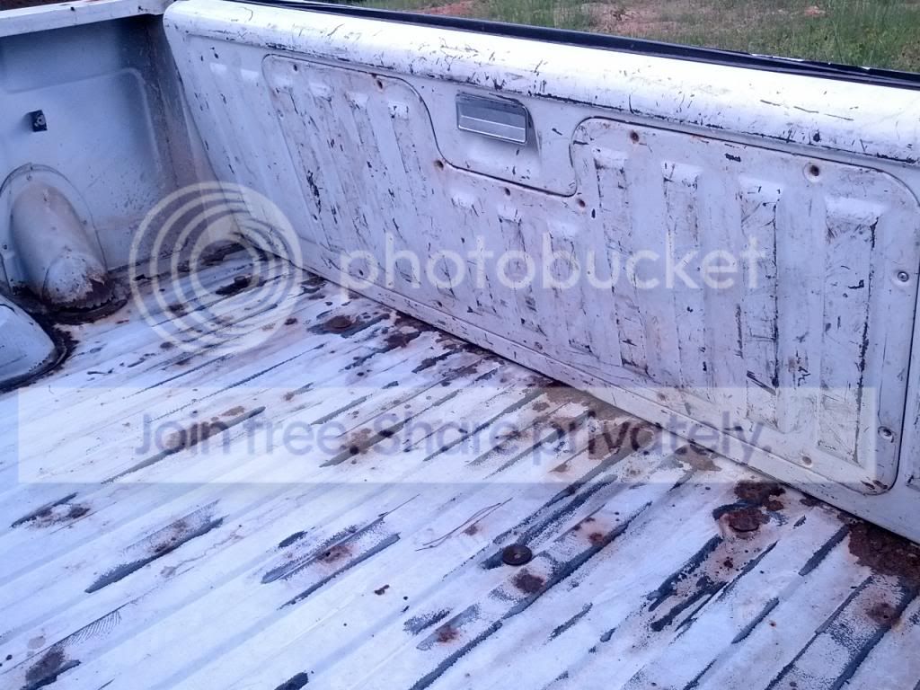

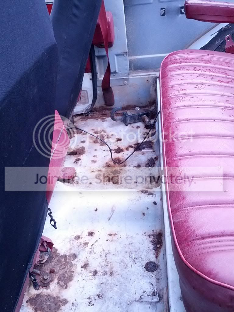

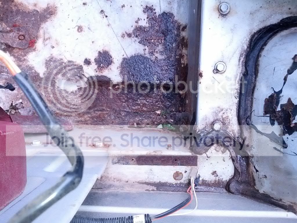

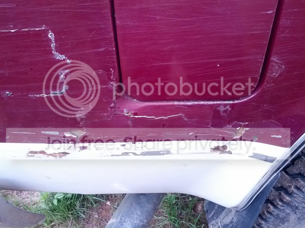

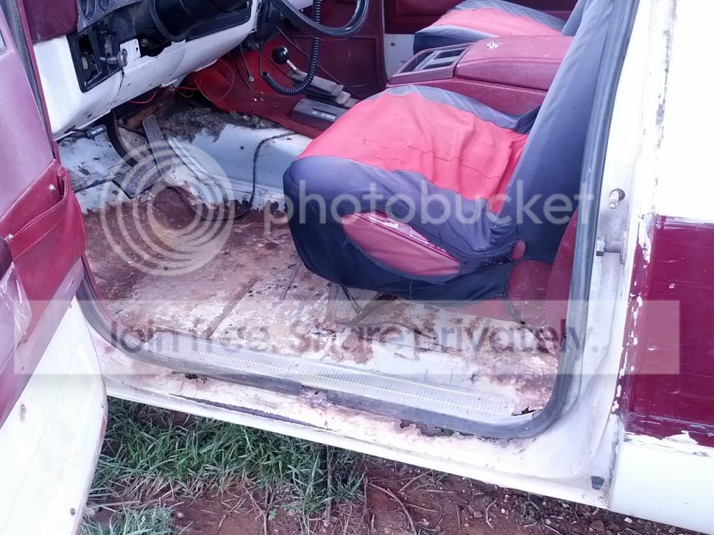

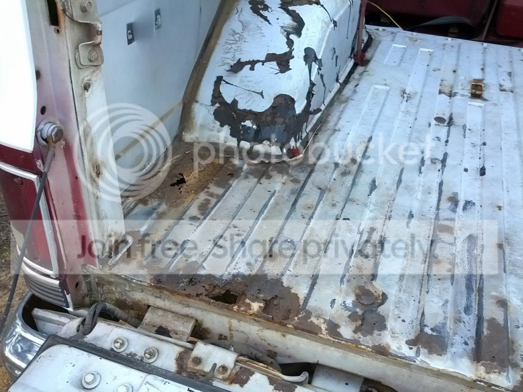

Took the top off, ripped out most the carpet and trim. Rust everywhere.

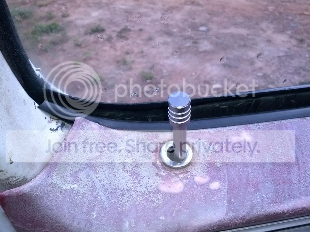

Power window motor on driver side went out, replaced the motor, ordered a window seal kit from 1-A Auto, did both doors, turned out swell. And put on new door lock knobs.

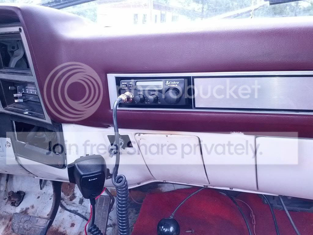

Put in a CB today

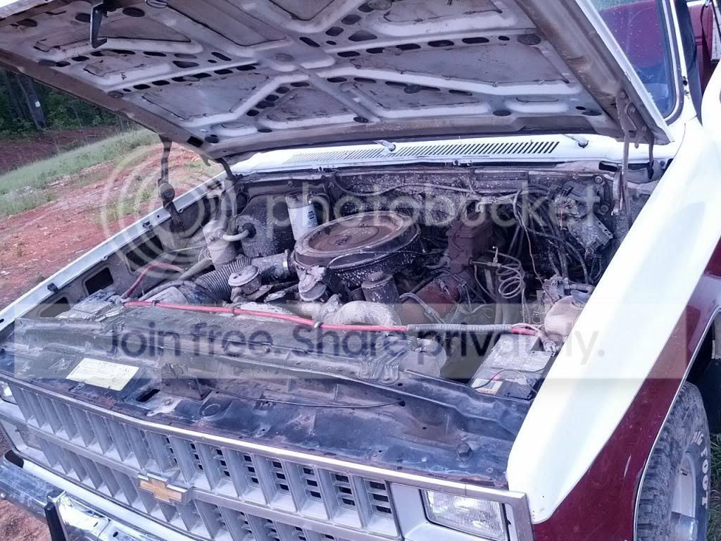

Here's my filthy engine compartment from going wheeling last weekend. Toss in a new alternator a few weeks back, new belts. Still friggin squeals. Ripped out that padding stuff on the hood.

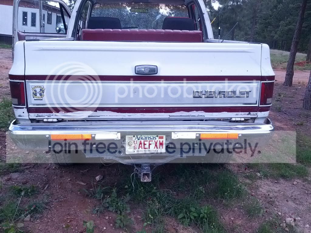

Hopefully my next project will be bumpers. This home brewed hitch is just way too low, unfortuantly it's the only thing protecting the fuel tank as well. So I need a skid for that, and fab me a bumper.

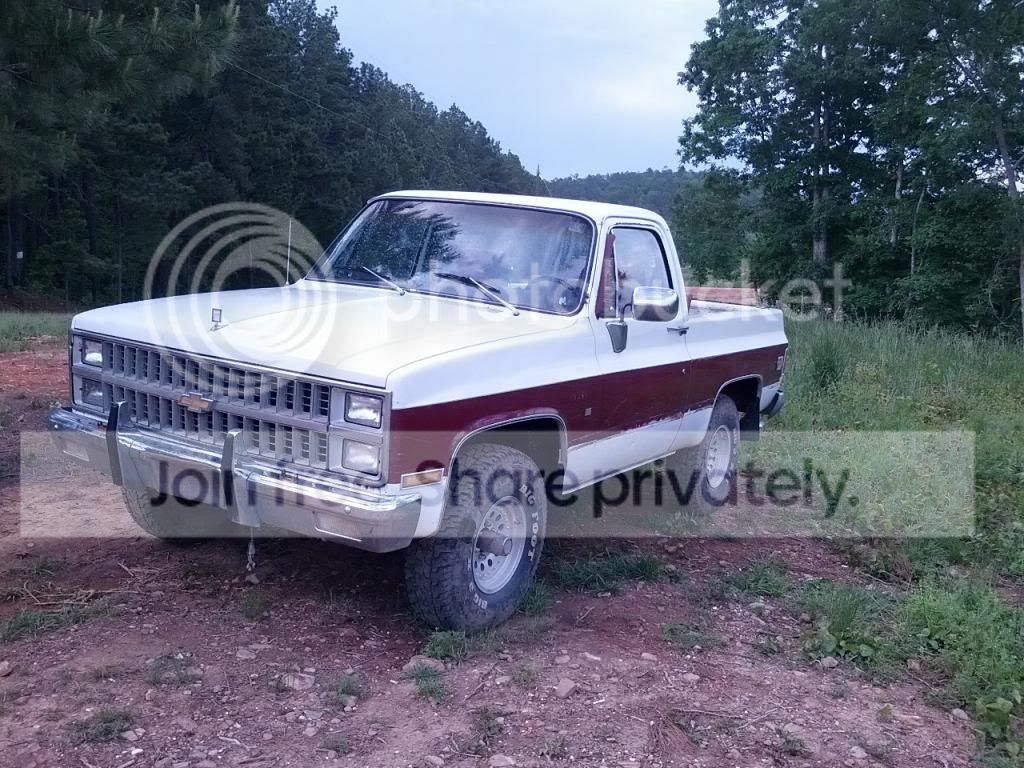

And here's the sexy sumofobitch as it sits now. Air dam ripped off, debating sway bar removal.
