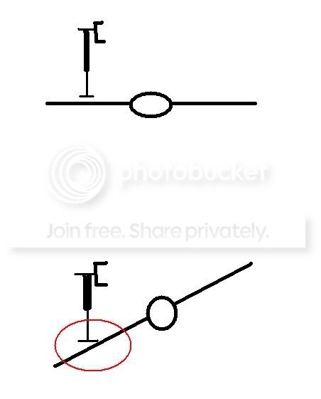

This is what Im talking about. If both mounts were parallel to the axle wouldn't the bushings on the shocks bind on the bolts at droop. Sorry for the crude drawing.
My axle is pushed back with 56s and I use the factory shock mounts at the frame for now. On the axle I used Kerts shock tabs becasue my stock mounts were already removed when I got the axle. They work fine but I will be going with an inboard kit of some kind or I will make it myself.
But to answer your question you can use the stock shock mounts on both the frame and axle but will not be ideal since the shocks will be at different angles in relation to axle centerline.
