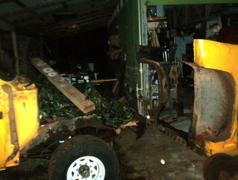

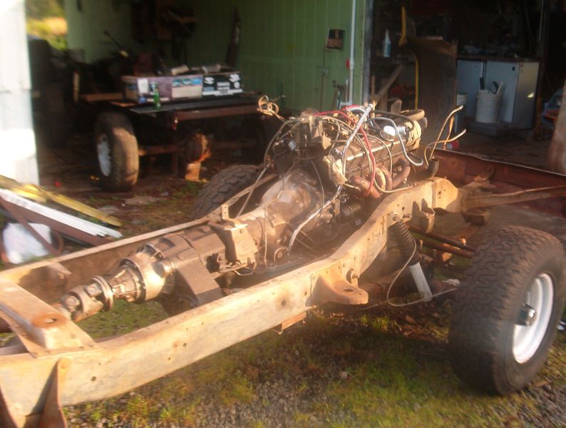

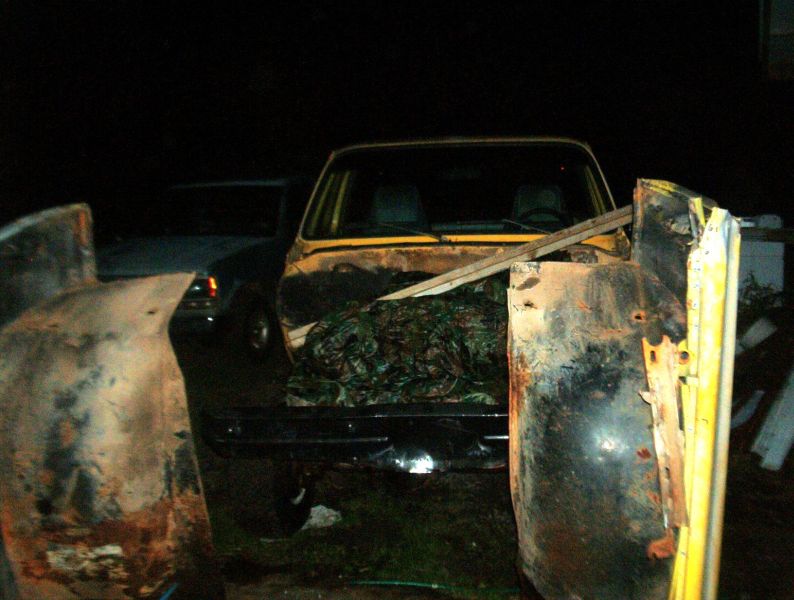

Today's progress. I gutted the electrical out of the yellow truck tuesday, only cut about a half dozen wires, will be reusing the harness and fusepanel in the new build. Spent 2 1/2 hours gutting everything useful from the tub, and removing front clip. Truck is now a tub with seats, a steering column, a motor, trans, tcase, and axles/suspension. Significantly less than before. Heres some *really* bad pictures. Old camera thats dieing, in the dark. Front clip came off as an assembly, inner & outer fenders, rad support, various brackets and such that go with those.

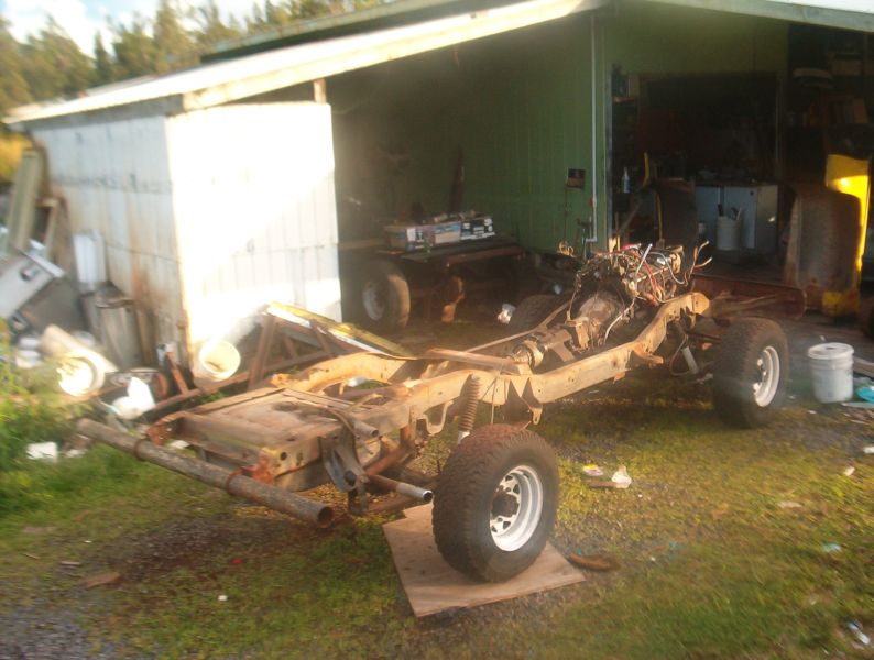

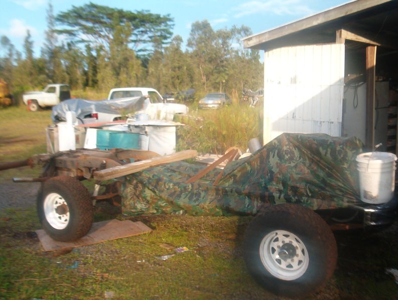

Body is OFF. About another hour worth of effort, and a little help from the backhoe, and the body is gone. Chassis, suspension, driveline, and nothing else.

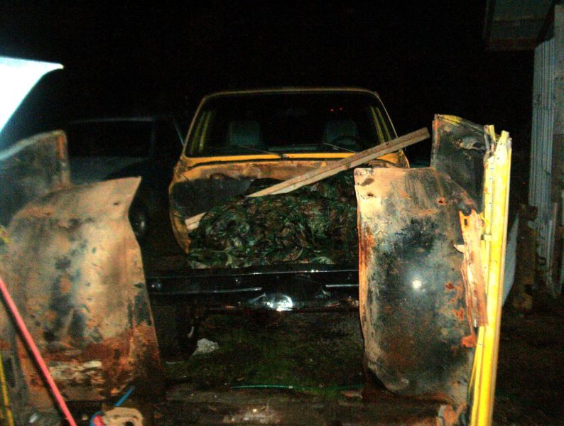

Little more work tonight. Dropped the gas tank, will relocate (or use a fuel cell) right behind the cab, probably under the flatbed floor. Exhaust came out, didn't have to cut it at all, amazing how much swinging room there is with no body. Bumpers are off, and in the trash. Looking at the back end, I think I'm going to cut the frame right behind the spring hangers. Something like 12-14" of frame that just doesn't need to be there.
