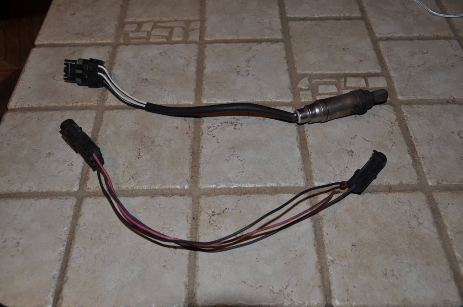

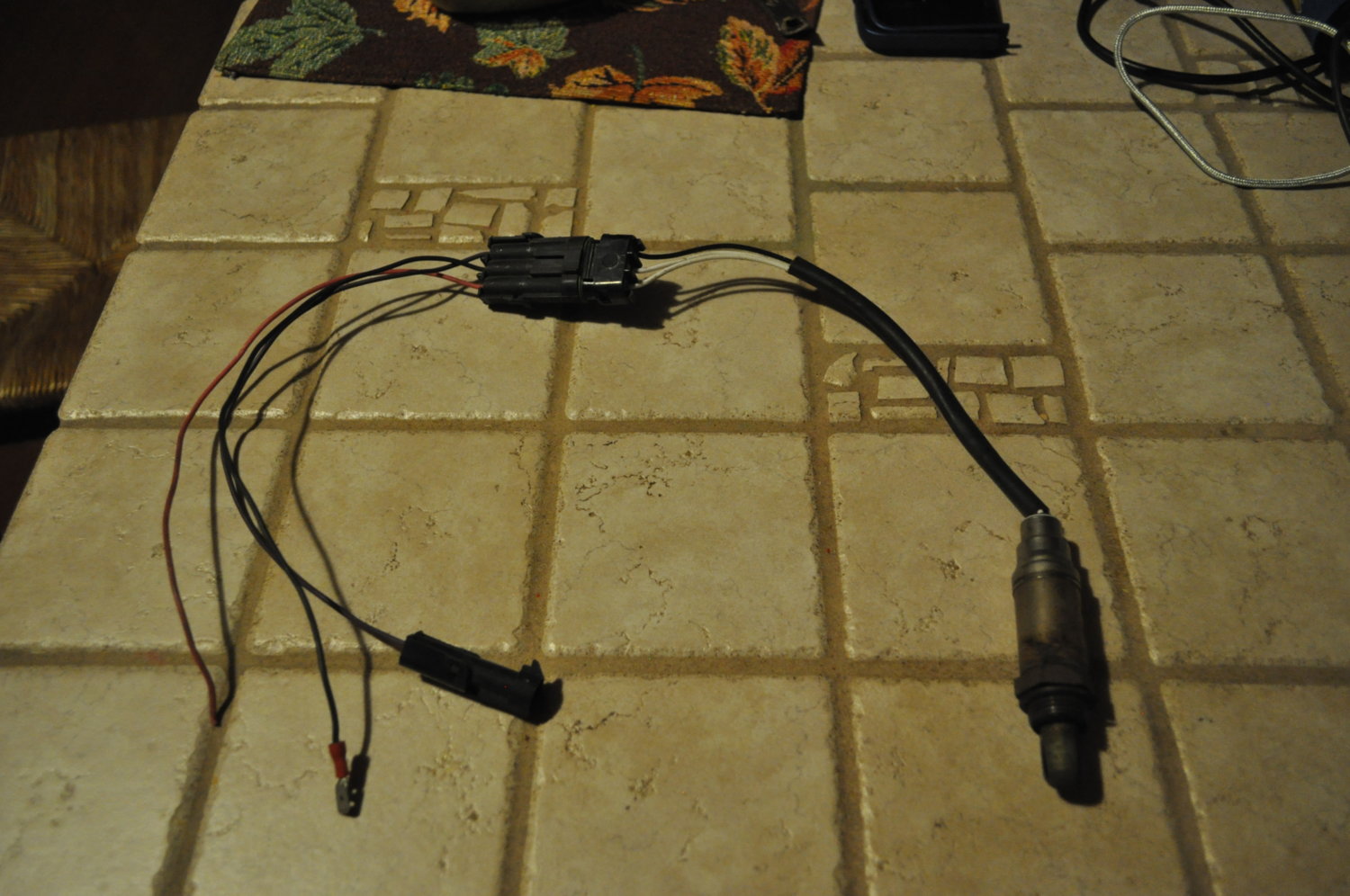

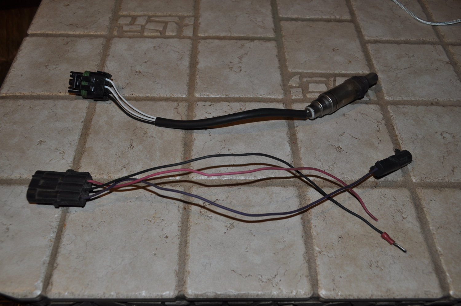

Let me check and see what I have. I sold my 350 TBI and I don't need the 02 sensor. If it suits your needs you can have it for the shipping.
I think it's the heated 02. But let me check.
The O2 sensor that I have is a 3 wire heated sensor. If you want it you can have it for shipping. If not, it goes to the next in line that wants it. I have no use for it and it will sit on the shelf until gone.
It's 9" to the 3-way connector.
