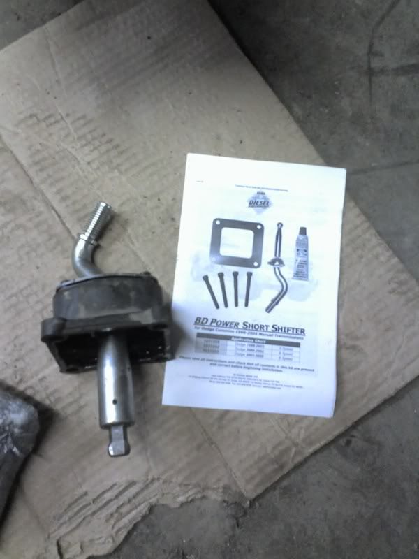

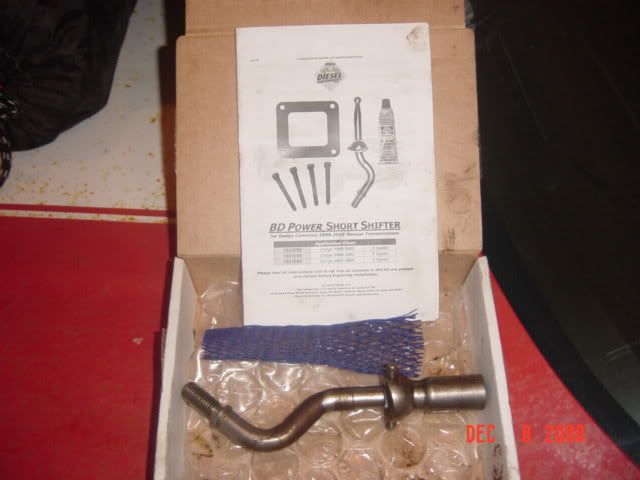

heres a couple of pics 1 is the stock lever 2 is the short throw lever. notice the length difference between the pivot and the foot. the geometry change is what shortens the "throw" its a simple lever and fulcrum dynamic. you raise the pivot up by installing a longer lever, and you add a spacer under the shift tower. so you loose torque but gain speed. you know teeter totter....move the pivot around.
I had a pic of them sideby side but I don't know where it went......
