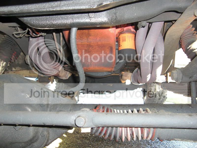

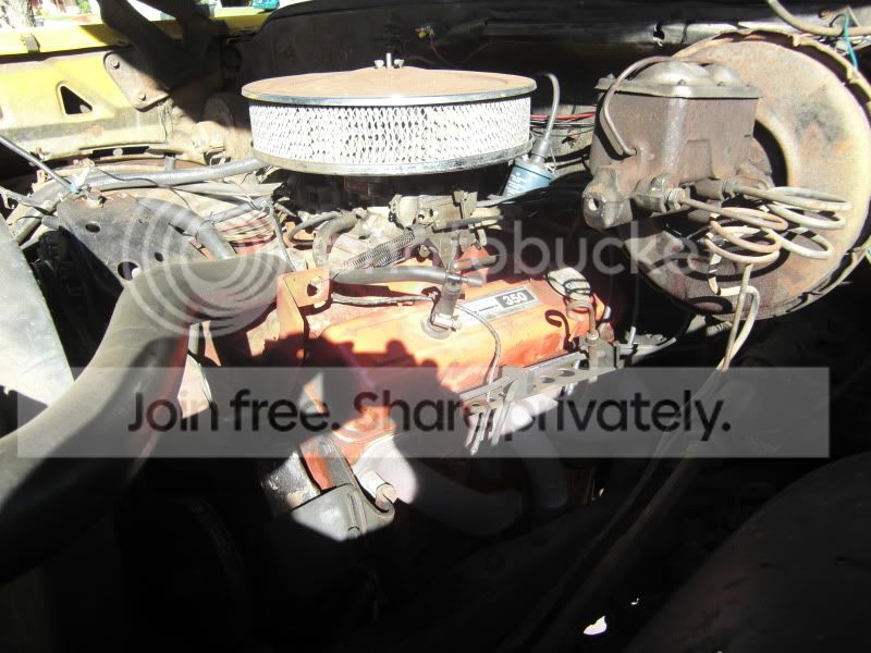

I'm also running of the cheap ones to but from Jegs(part #555-30055). I am so far impressed for the price they came with gaskets, bolts and collectors, and fit perfect with no interference with the shackles nor starter although the coating that is on them was a little lacking. But rember you get what you pay for.
