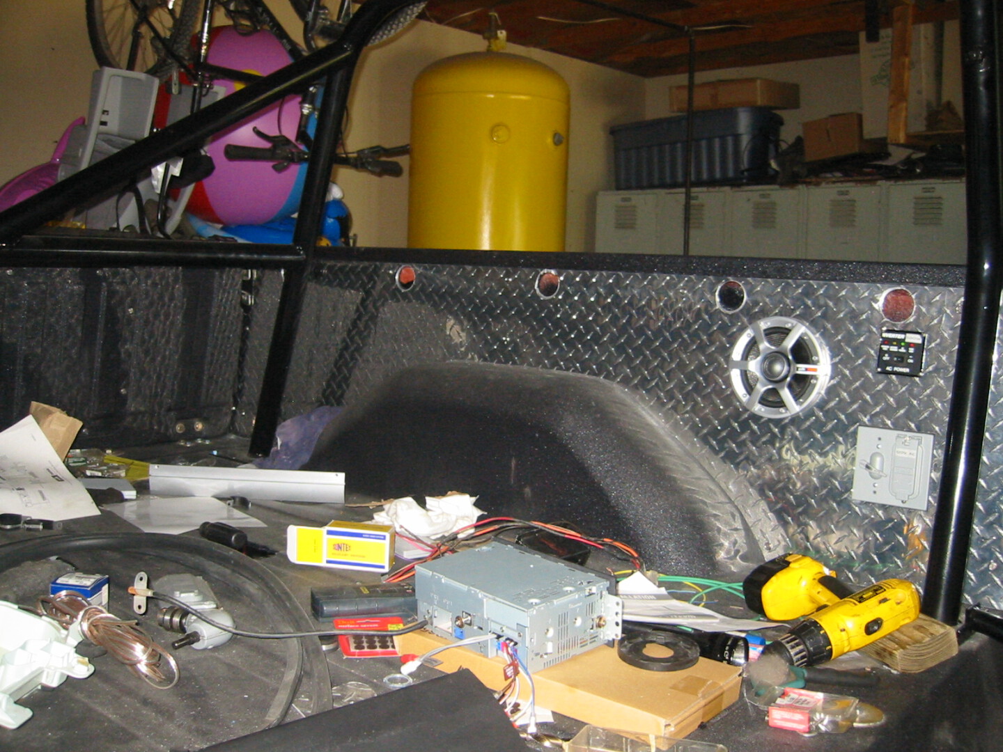

I did mine in Alumabrite diamond plate.
Hey 73k5, I like that look. I've been looking at the same thing for aawhile now. I can't seem to choose between the .100 or the .125 panels. What did you use? Looks like yu have fiberglass insulation behind them too? Might it be wise to back the aluminum in thin carpet or the like to keep the rattling down? What are the round holes in the top for? Thanks.
It was .125 thickness.
My truck is a fiberglass body. The way the glass body came, those quarter sections were already boxed in, meaning the alumabrite is flat up against a fiberglass backer. They are packed with goodies, inverter, amplifiers, ac outlet, subwoofer, full range speakers..etc. See here.
I backed the back of it with little padded feet, simliar to the things you would buy to put on the bottom of furniture legs to protect a floor.
The holes are for top bolt access. I have covers for them.
