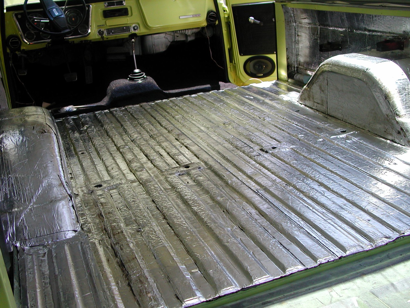

Got a pic of those little buggers somewhere...
Rear bedside panels were spot welded to the bed floor though.
If it's a CST, it will have a chrome t-case shifter too.

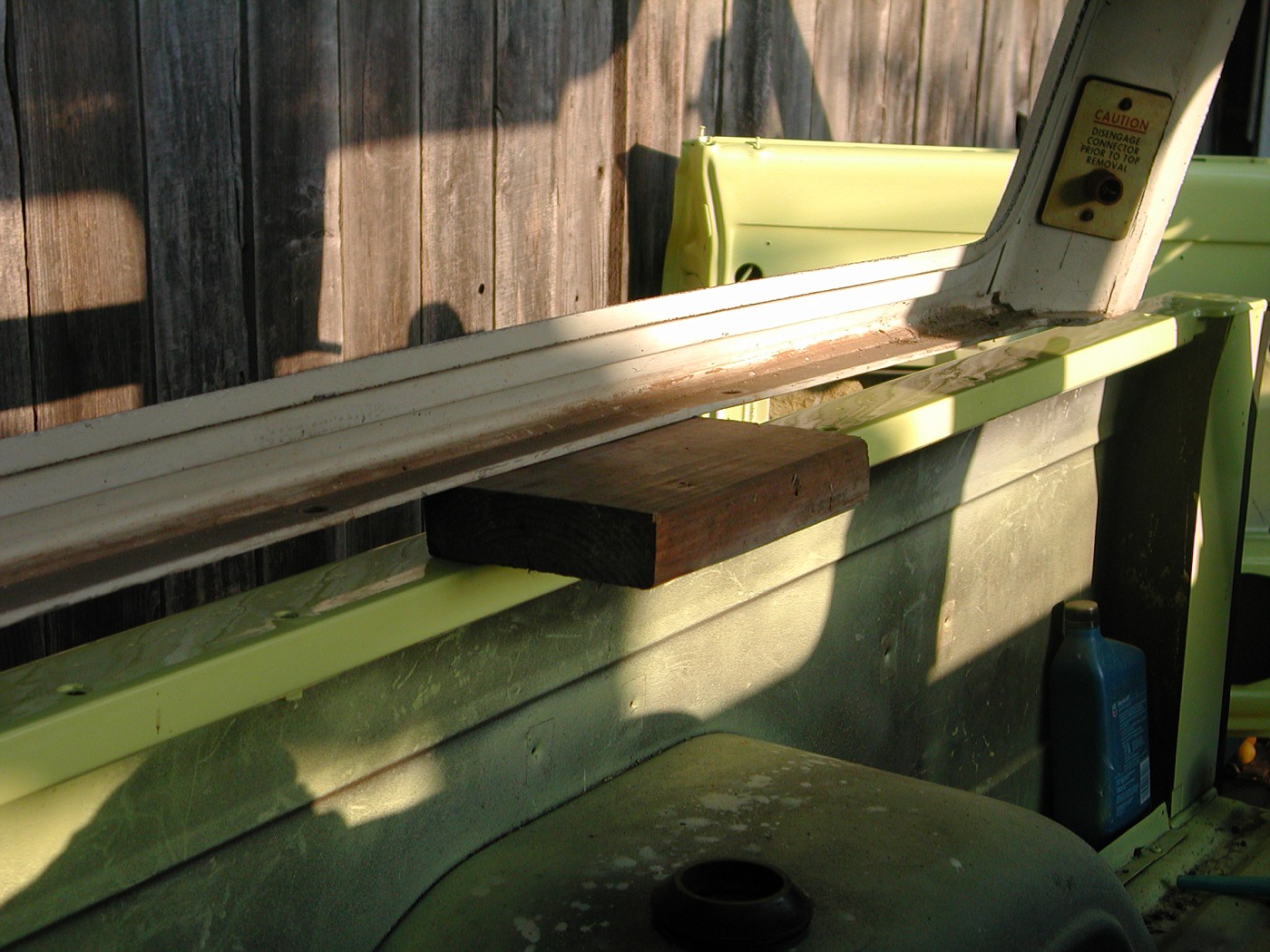

Mine are attached with screws.
Here remove for some reason.
You can kinda see them here.
Oh ya,chrome T/C shifter
