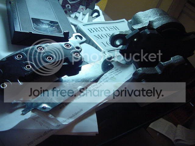

What is the point of the adhesive thinger in the bottom left of the picture? Is it a shim? I've gathered that it sticks to the outer brake pad, but do I need to install it???
Got my front calipers on.. Bought another set of calipers today also. I'm gonna start on the rear disk brakes very soon :D
as mentioned, it's to help prevent vibrations,,,what wasn't said, is these vibrations are what causes the brakes to squeel.
I always use them.
I bought premium Raybestos, the silencer shifted and bent the little tabs, the contact cement must have softened. I took them out. I very rarely get noise and when happens, I step harder. I also have drilled rotors so there is an escape route for dust and "gas".:D
