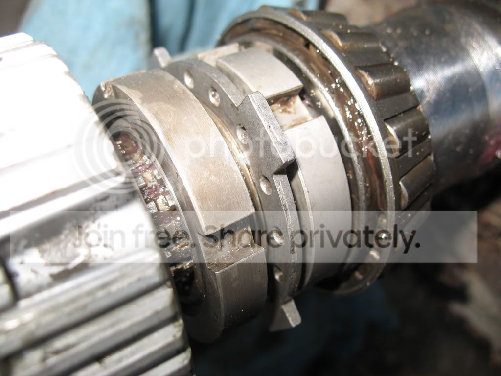

Hey guys sorry for another one of my questions, but...
I just replaced all the ball joints and front u joints as there were not even any bearings left in the caps! :eek1: ( a miracle 4x4 even worked! ) It's the worse I've ever seen a u joint! But anywho, is this how the bearings/collars go on? obviously the back bearing is not on and nothing is tightend down, but it's just for representation :
<a href="http://photobucket.com" target="_blank"><img src="http://i8.photobucket.com/albums/a18/gkbriggs10/IMG_2097.jpg" border="0" alt="Photo Sharing and Video Hosting at Photobucket"></a>
Thanks guys
The orientation is correct but make sure that the first nut that goes on has the little pin in it and faces outward, then the washer needs to line up with the pin then the last nut goes on.
It is a Warn product i got it from 4WPW but i think it has been discontinued.
