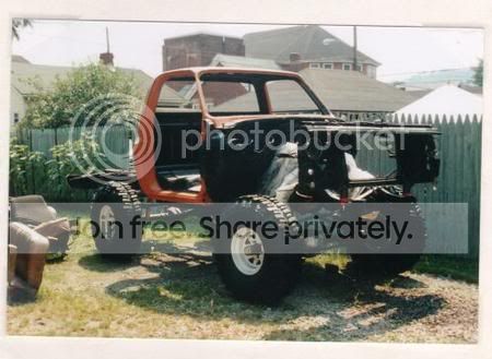

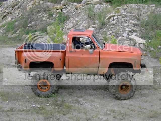

just search for trazer...there are quite a few of them poppin up...:D
Does mine count as a trazer if its a 68 truck cab? hah

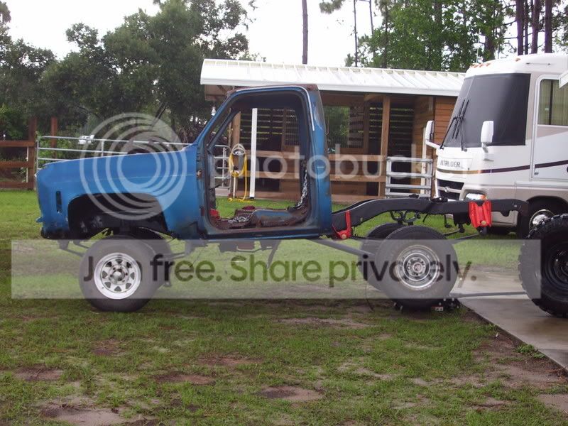

Only reason you wouldn't be able to use it on the road is if you ran into titling issues. Frame & cab vin don't match obviously. Since I own both the blazer that donated the frame and the truck that donated the cab, I'm not too worried. I'm registering as the cab title, since thats the vin anyone would look at. Insurance will be a SMIDGE higher, and if I ever move to a state that does registration absed on GVWR, it would be more expensive as well. Cab came off a CUCV 5/4 ton truck.
