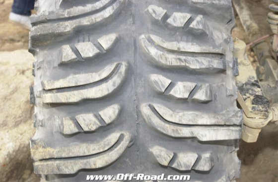

My personal definition of the techniques.
Sipes:
Grooves:
Cuts:
Soooo....if I had the choice I would either sipe the hell out of them or groove them perpendicular to the tread blocks. I've had some problems on my A/T's with pearock getting jammed in the sipes and chunking the tread. Nothing major, just a little annoying with brand new tires.
