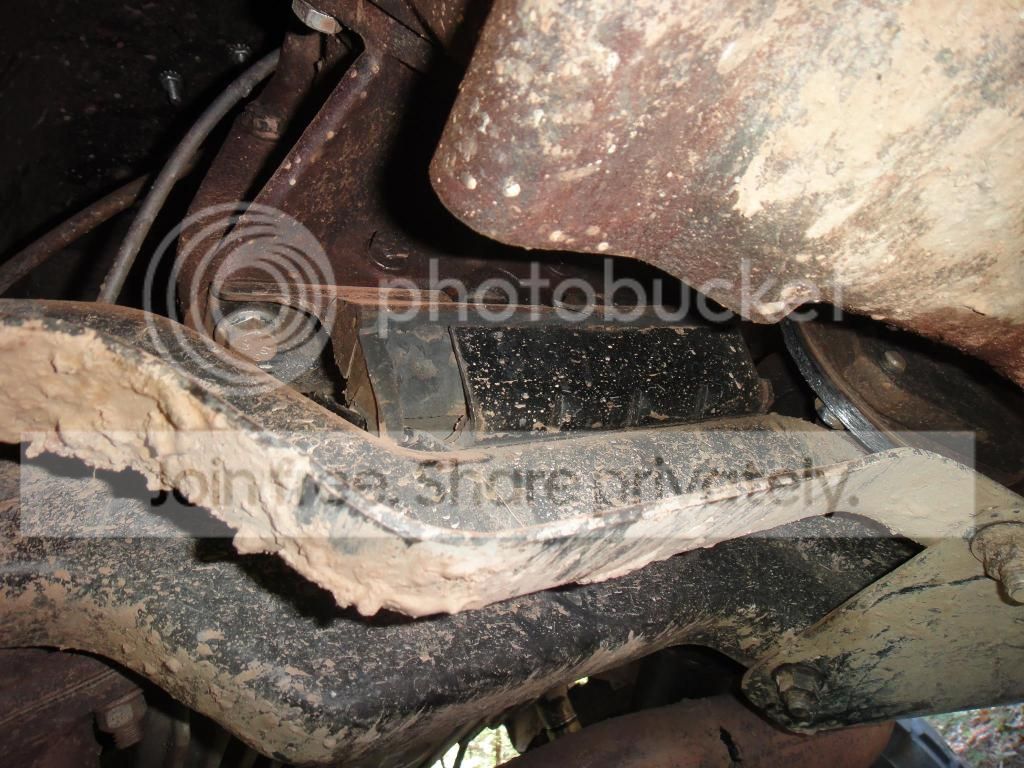

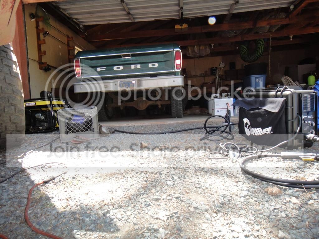

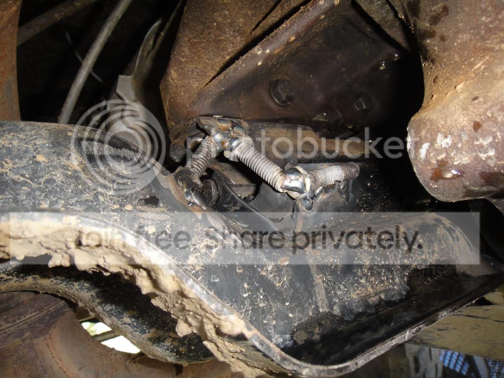

Totally disintegrated the transfer case mount on my truck the otherday while skidding a giant cedar log. Blew all the rubber out, broke everything inside of the mount, and shifted the entire drive train so far to the drivers side, that the front out flange on the transfer case wore a 1/4 deep groove in the cross-member. Shifted about 2". Buddy busted out the passport and generator, 3 grade 5 bolts and 10 mins later, I had it welded up enough to atleast get it home. Time to build my own, better x-member now I guess, lol.
The amount of disgusting, stinky, burning, rubbery napalm, liquid and smoke pouring off of this thing after these "welds" was unreal. Smelled soooo bad. A hard mount drive train sucks by the way.

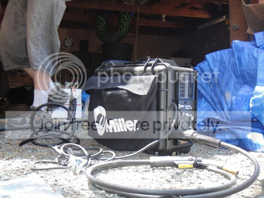

Thats a cool looking welder unit. What model is that, and can it run gas?
It's a Miller Passport. It's totally self contained. EVERYTHING is in the suitcase. Welder, gas bottle, feeder, wire spool, everything. As pictured, it would cost you about $2k. It runs on 110 and 220. It is capable of running ANY kind of wire, flux core, stainless, mild, aluminum, spool guns, everything. That particular gun has a 360* rotating head for out of position stuff, just twist the locking collar and rotate, then lock the collar back down. It's a sweet setup for sure.
I guess it's called the "Multi-Matic 200" now-
http://www.millerwelds.com/products/multiprocess/product.php?model=M00361
It runs pretty good on a cheap-ass 4000w 220v generator at the highest heat setting. A better quality generator would run it even better. One of the badass Honda inverter generators would be perfect.

If you look at the first video where I'm hooked to the log, at about the 1:35 min mark, it took a big, hard hop. That's what broke it. Wasn't broke before, I would have noticed. I was in low range, foot on the floor and that log is way bigger than it looks. 6' long and almost 40" in diameter. Truck weighs 8K lbs. Cheap ass $15 autozone mount couldnt handle it.
As for the small logs, no damage there at all. They tried to murder the kingpins and the 1/2" wall 1.5" DOM tie rod. :haha:
The updated model looks really impressive. Have you used it for stick also? I have been looking for a welder as I just borrow a crapsman one right now. They have a rebate that brings it down to $1,637 if you buy before May 31st. Would that be a price to jump on?
I've never used one for anything but mig/wire welding, all types, to include spool gun. No experience with the stick/tig features. I haven't looked at the specs, but I'd imagine it has an inverter power supply in there, and those types of machines ALWAYS weld really nice tig/stick. And yes, at that price, I'd jump on it. Also make SURE you get the 360* rotating mig gun...that thing is worth its weight in gold. I think my buddy said it was a $40 upgrade. What you see in the pictures cost him just over $2k. He's on his way over here now, I'll ask more specifics when he gets here.
