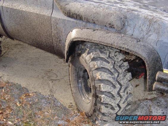

i used to wheel with 350 motor, turbo 400 trans with stage 2 shiftkit, np203 fulltime case, d44 up front 4.56s and open, 14bff drums 4.56 and open, 33" firestone 23 degree mud tread tires
I wheeled this puppy and had fun... while a dd and weekend warrior... you start adding detroits, 1 tons, large meat, lift expect your DD to be down sometimes and dont count on it being available for work.... im not saying you cant but you got to look forward...
