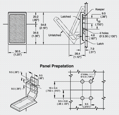

Do any of you guys that have gotten rid of the sliding windows have that little metal piece that is glued on to the slider that the latch fastens to? I am missing one of them and haven't been able to find a place to get one.
You talking about the part on the right?
If so guy sells them on eBay whole part new cheap under $10
No that.s the latch itself which I've found at pep boys. On the sliding part of the window there's a metal piece that's glued to the window that the latch attaches to. Here's a picture, it came out blurry cause it was dark but You can see what I'm talking about. The other side is missing that metal piece.
not sure on that maybe measure the thickness then cut a flat bar stock and use rear view mirror glue to hold it after you drill and tap screw holes?
Yea I've thought about doing something like that, Haven't been in a big hurry to fix it. Just thought someone might have one laying around and save me the trouble of making one.
