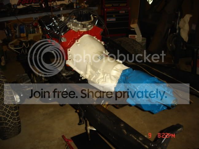

Here's the white elephant slip yolk 205 that I'm sick of people saying doesn't exist...

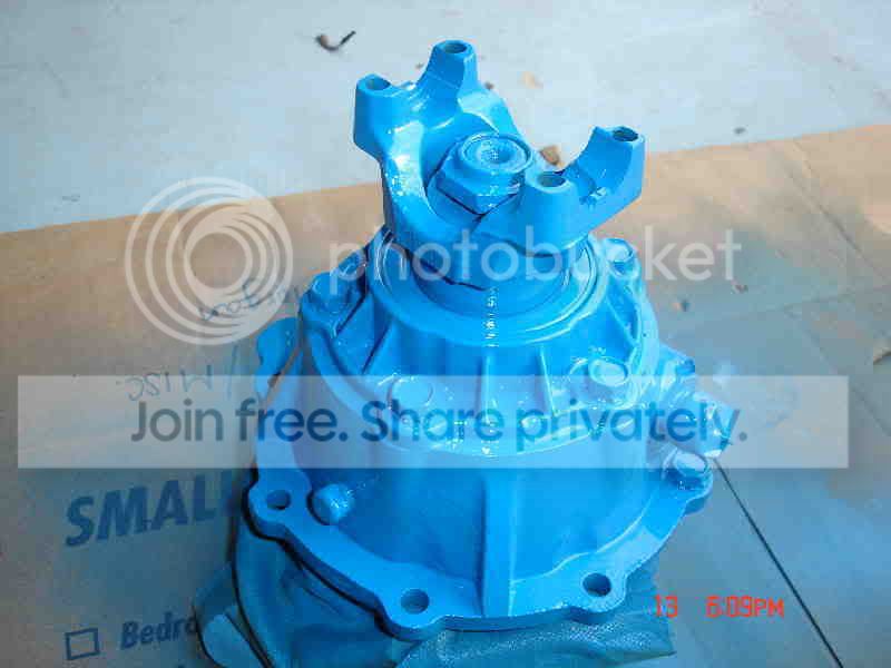

And here is how I eliminated it....
You can swap fixed yoke out of another 205 easy as pie....
