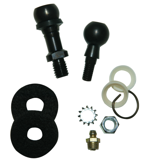

I'm having a hard time finding the hardware for my bell crank that goes between the frame and engine(through the bell crank). Anyone know of a place to buy it?
Of course I haven't tore it apart yet, so I don't know what it even consists of either...
So to follow up a bit... mine is falling apart and this is the only repair kit I can find
The only issue is the price, at YearOne its about $66. Does anyone know of another source for a kit or where I could purchase these parts separately?
I've bought the ball studs at Napa before. I've also had probelms with the tube that rides on the studs wearing out from lack of grease.
