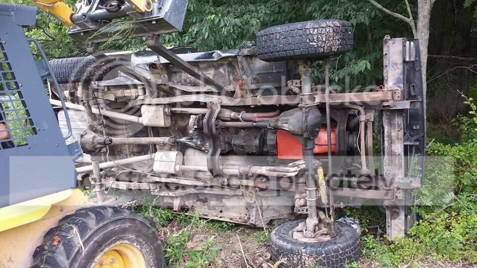

Out with the tired TH350
Best way to remove old trans and install new trans,made it pretty much plainless
Clutch Master Cylinder installed after drilling out new hole
Last connecting Piece Needed # 348 Combo Joint from napa
Donor Truck complete
Read more about this build here...

Stripped what we could off the donor truck and left the rotted tub in the back 40

the floor of the donor was completely rotted away in the back, also had rust in the roof and the firewall.. looks better in the picture than it really was.
