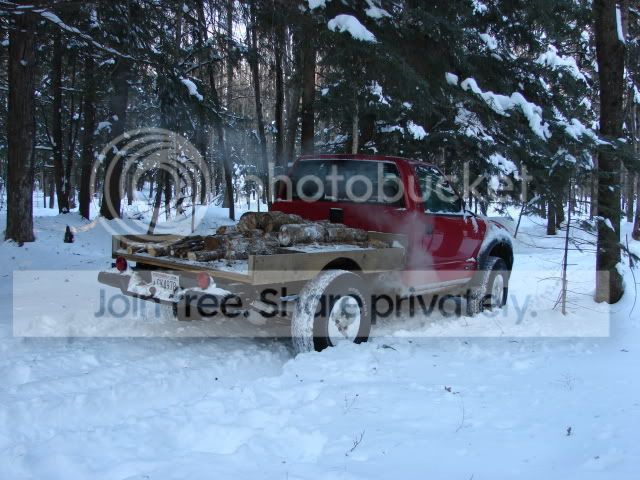

I run BFGoodrich Rugged Trails on my 1971 CJ5, 1994 S10 ZR2 and 2000 XJ. I am satisfied with them. I used to run the Cooper Discovery ATs on the XJ but several years ago when they changed tread patterns my tire guy told me they had tracking problems on some vehichles and the XJ was one of them.
I have 35 X 12.50 X 15 Dunlop Mud Rovers on my Jimmy. I only have a couple hundred miles on my rebuilt tranny so I don't want to beat it just yet but I had to test Jiminy after last week's 19" snow storm. I was satisfied with the results.
