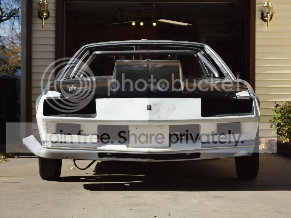

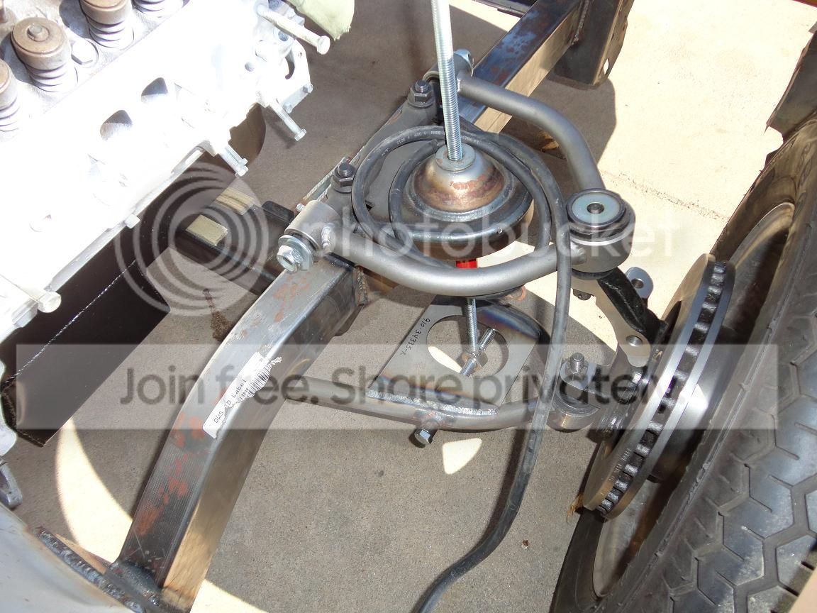

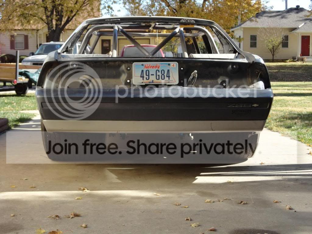

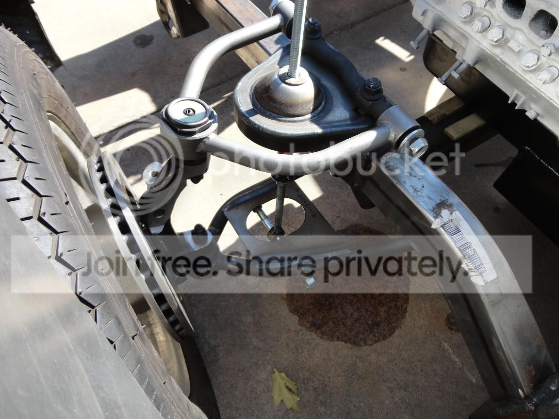

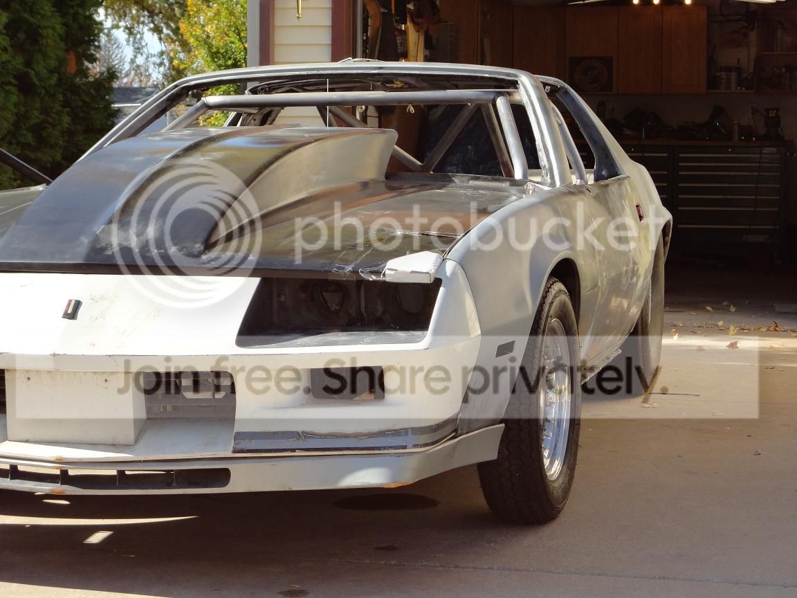

Helped my brother redo the front end of his pro street car that he's in the process of doing a bit of a rebuild on.
Of course, lots to be done yet. Engine cage is the next step and the rack and pinion steering needs to be installed. Some 2" drop spindles will be swapped in. The hub/spindle combo we had to work with had something out of spec. The spindle is either too short or the inner bearing race bore isn't deep enough in the hub. Couple threads is all we could get on the spindle nut. Wheels should sit in another inch or so per side.

That's sweet. He's not gonna have much visibility out front of that thing!
You're right about that. If he has his way, first little ways down the track, even less.
gives a better look outside Kert...my eyes were pretty fuzzy when I looked at it last time.
so you guys got the firewall/frame setup all ironed out then?
Yep, pretty much set in stone at this point. Worked out pretty good in the end. Just a little to high in the front though and nothing more could be done about that with the frame sections and suspension without sacrificing to much room somewhere else. Drop spindles will have to do the rest. Then it should have just the right amount of rake.
Not sure what the final weight reduction on the front was but significant.
