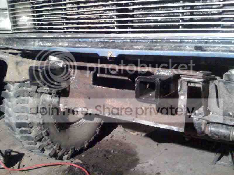

Here is a picture of how the winch is mounted but the winch wasn't on in this pic.
The winch has the warn label up with the motor on the left side and the freespool lever on the right (drivers) side. I was under the assumption while building my mount the winch spooled the other way. Now that I realize I was very wrong I guess I will email warn.

WELL PISS!!!!!! I just got off of the phone with warn and they said if I am spooling in under load the wrong way then it will be acting against the brake which will cause problems. ****! I guess I will have to cut a new hole, weld up the old one, get a new bumper and remount the fairlead. Thanks guys!
Generally speaking, a low slung winch should pull in over the top of the spool. Among other things, this lets the fairlead be on top instead of hanging down below the winch.
