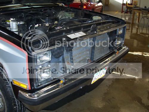

I have a slow week ahead of me here at school (automotive technology), so I figured I would install some LEDs on my 84 Blazer.
the blazer
took the grille out

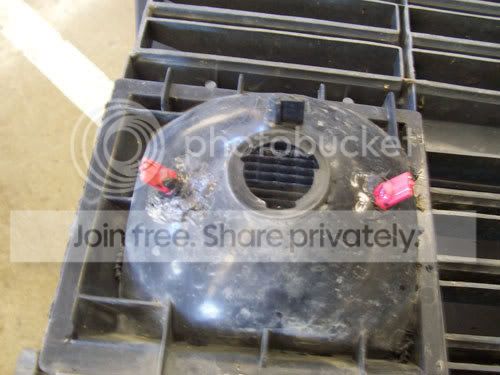

LEDs glued in

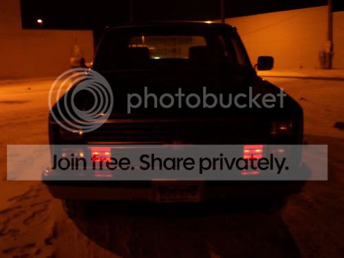

the final product
I don't think it turned out too bad. The lights are wired to a switch, so they don't come on if I turn the parking lights or headlights on.
I plan on upgrading to an 81-82 bumper with the parking lights right in the bumper as I will be installing some red LEDs there too.
How does it look?

I think he just wired them seperate from his turn signals so it still uses the factory bulbs and the LEDs are just an added effect.
They look cool, nice job.... but just my opinion, but I'd leave the bumper you have. Never been a fan of those 81-82 bumpers
eclipse - the lights are indeed wired seperate from the factory lights. I have them wired to a simple switch below the headlight switch that has a red LED that comes on when the lights are turned on.
