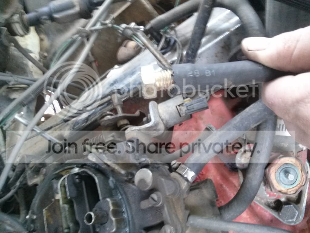

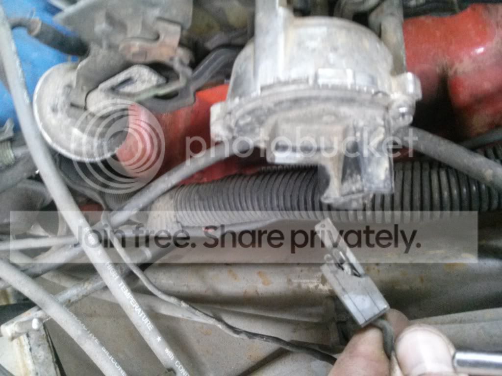

Choke???? Wire that was sitting atop the manifold right under it
Choke??

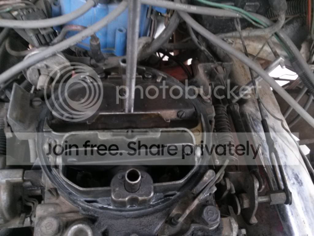

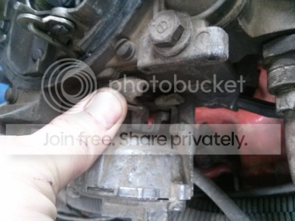

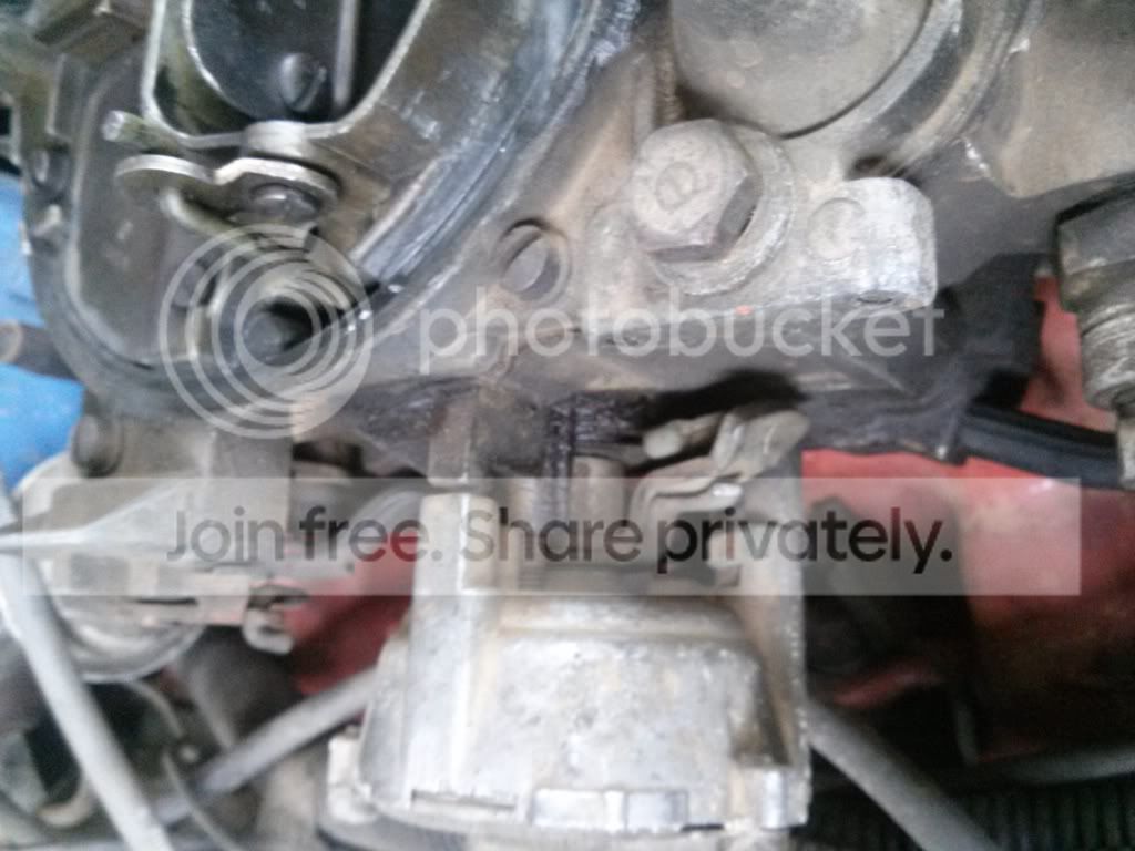

This piece has no tension on it either way, and appears to do nothing... the other piece below it manipulates the flap over the primary, which is open 100% of the time, always... running, not running
Like this

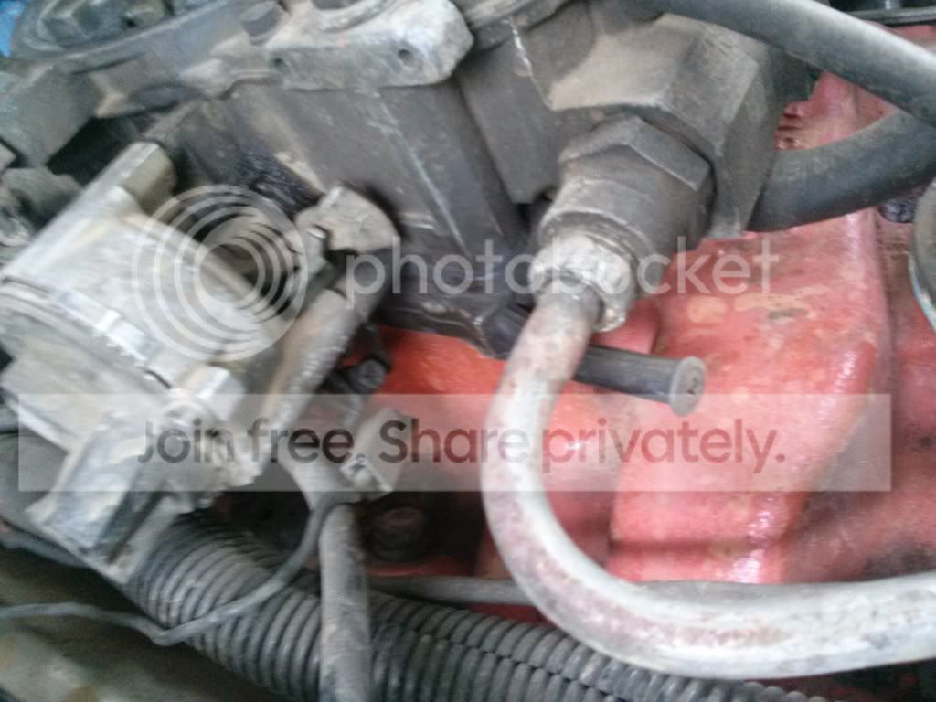

Heres the hose with the bolt... classy. It attaches to the carb below my hand in the pic
Then theres this plugged up hose.... you can also see what i believe to be the choke, and the mystery wire on the left
Thats a Quadrajet carb,not a Carter AFB...the choke is electric,and is not hooked up,without the wire hooked up to a keyed 12V source,it will never let the choke fully open,and it will foul plugs and flood,and thats why it idles lousy probably...the plugged off hose might be for a PCV valve,which is a must to have hooked up and working right,the smaller hose plugged off probably used to go to the thermostatic air cleaner "door" ...or maybe the choke pull off,which also must work to let it idle after a cold start without over-choking ...

The large plugged up hose- what would that hook up to? An orphice in the valve covers???
The small plugged up hose- what would that connect to??
Under that black cover where the choke wire plugs on,is a electric heating coil with a thermostat spring that operates the choke butterfly...when its cold the spring contracts and closes the choke,when you start it,12V goes to the electric choke and begins to heat up the heating coil inside it,then the choke starts to open slowly..the thing gets 12V constantly any time the key is in the "run" position...also the choke vacuum pull off (behind the choke on your carb) opens the butterfly slightly to prevent flooding or over-choking after a cold start...
Looks to me like that bigger hose was going to the carb bowl vent,which usually goes to a vacuum charcoal canister in the fenderwell--the PCV valve looks to be hooked up,it goes to the valve in the valve cover,and should plug into the large nipple on the center of the carb up front on the base of it..the smaller hose could be for the vacuum advance on the distributor or the air cleaner door,or many other smog related switches maybe,depending on the year of the engine,etc..

Ok your choke is probably unwound. loosen the three screws and rotate the center counter clock wise while holding the throttle open. once it closes the choke plate tighten the screws back. This will at least give a starting point. Check what you believe is the choke wire for power and plug it in. The broken part on the t-stat housing was a thermal vacuum switch. Since you want to remove the emissions controls you don't need it. The vacuum line with the bolt in it probably went to the factory air cleaner. My suggestion to correct the rough idle is to replace all the vacuum lines. Your carb is an emissions carb and was designed from the factory to run as lean as possible and therefore is very sensitive to vacuum leaks. Only replace the lines you need like pcv and vacuum advance, also the vacuum modulator line to the trans has rubber at both ends. last is the line into the cab to run the dash vents. Everything else you can cap off. (use vacuum caps)Then check your timing and adjust if necessary. If after all this you still have a rough idle then I would adjust/ rebuild the carb. Most Q-jet problems are from improper adjustments from backyard hacks. I have an 86 with all the emissions still on it and 11 previous owners per carfax. Anything and everything was wrong with this k5. Its taken awhile but I've finally got it dialed in. Happy Tuning!

my .02...the choke wire as others have said is unplugged, the wire with the broken blade connector, usually has a locking tab to hold it to the spade on the choke housing.

Take the air cleaner off before your next cold start and look at the choke blade. Then give the throttle a quick tap to see if the choke does anything. After starting the engine, watch to see if it moves and where it ends up when the engine is warm.
It should snap shut when the engine is cold and place the throttle on the "high idle stop". Then once the engine starts, the vacuum should active the pull-off to move the choke blade to "just barely open". As the engine warms the choke should open up and touching the throttle should drop the idle speed back down.

It doesnt snap shut. Its always wfo. Always. 100% of the time. It never, under any circumstance, unless manipulated by hand, EVER is anything other than WFO....
..... EVER. :)
