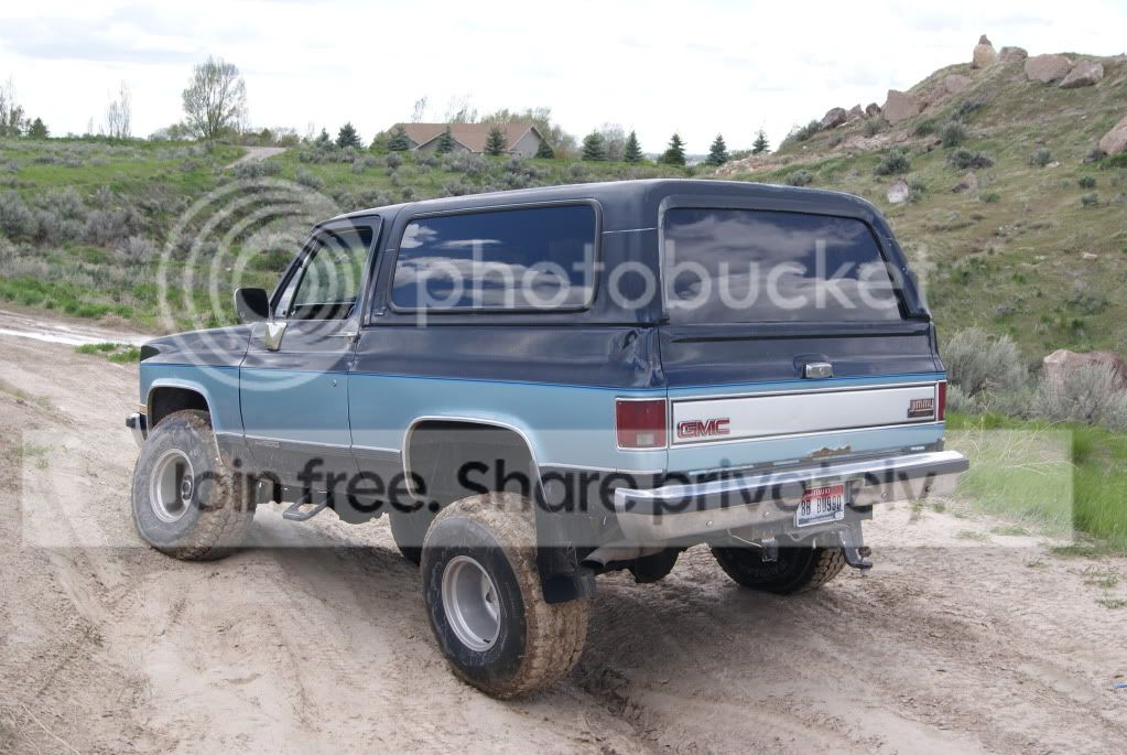

Oh one more thing I really like your truck.
Just like mine except a bit older.
Even a Goofy Made Chevy like mine.
Lemme know if you need help the wiring will not be to different in ours if at all so I might be able to take pics to help you out
Hey! thats a nice jimmy. :waytogo:
