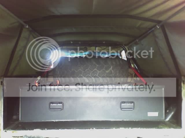

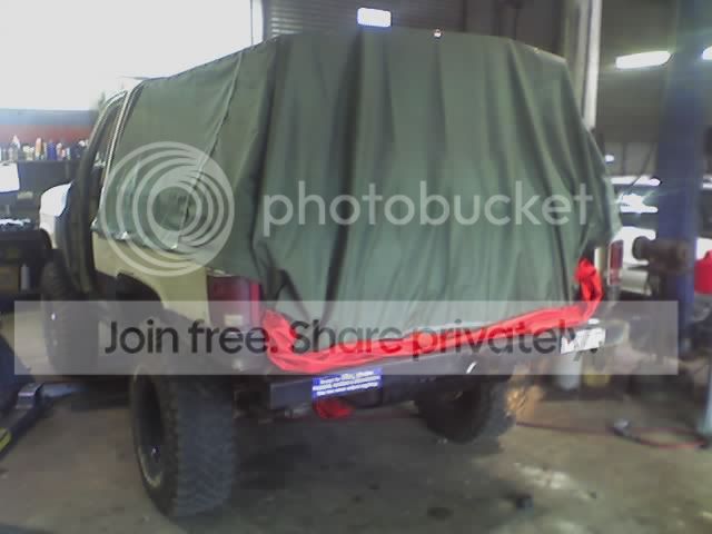

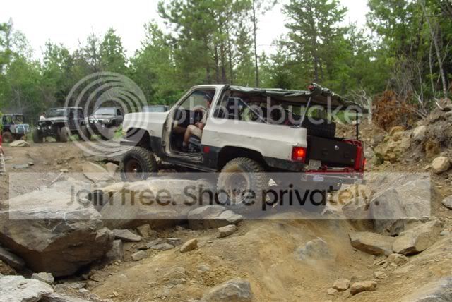

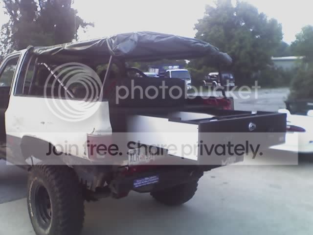

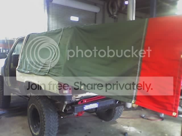

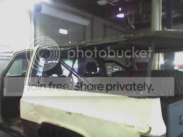

I made my own, It works pretty well... not watertight but pretty water resistant.
gabe
looks good, i wouldnt go as far to build that extension, but i am sure you had your reasons for it and it definitly works.
what type of materials did you end up using to build the top; canvas, metal, snaps, zippers, straps, ect...
Id be interested to see what all is being used, since i have yet to ever see a soft top manufactured by these companies in person.
The extention covers the rear toolbox when it is opened so that I have a sheltered place to work when we are out on the trail. I did it with two paint poles that telescope out. The frame I welded up out of 1 inch square and the canvas is actually cordura nylon I got at northern tool.
