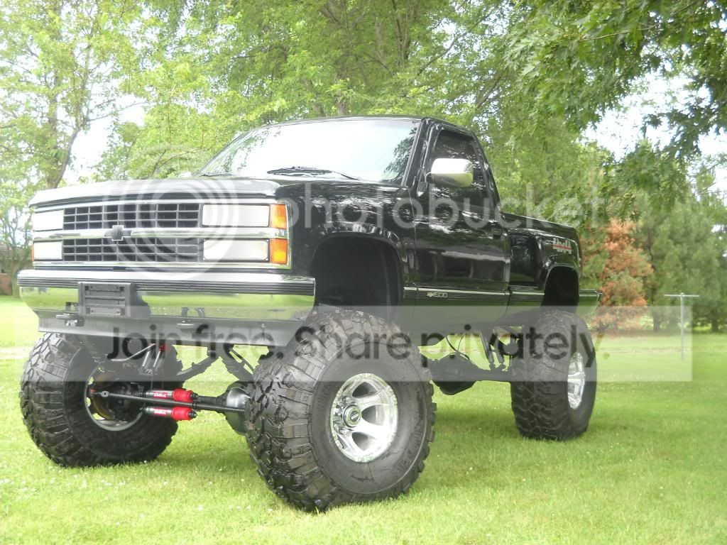

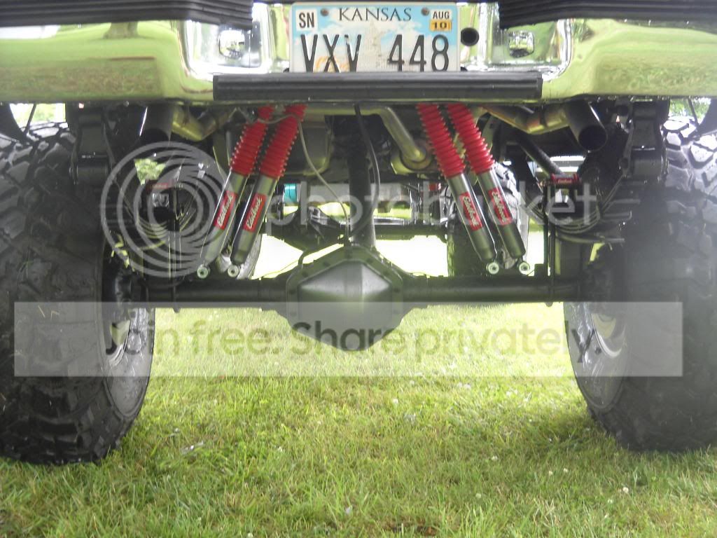

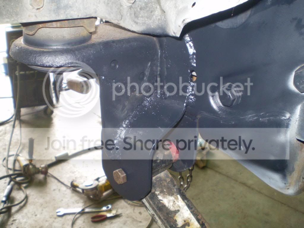

here is a 93 we did a couple years ago, making our own brackets
42in pitbuls, like said before 1500 bucks for brackets is tough to pony up for, but if you have no choice then thats whats you got to do
front hanger

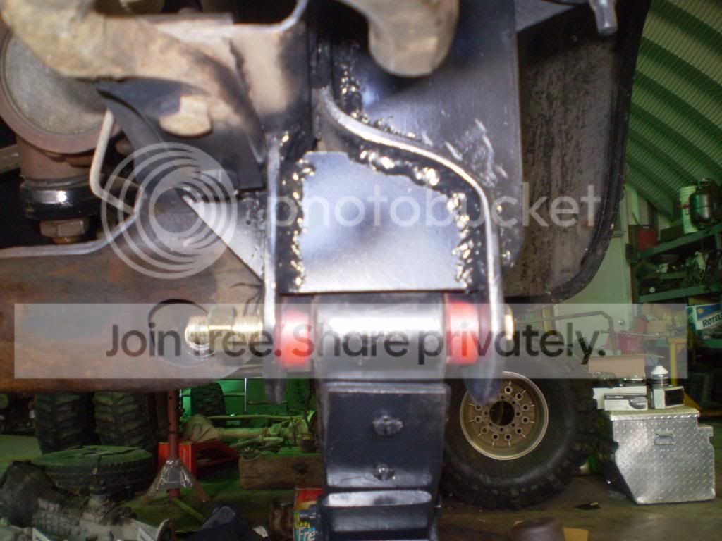

rear shackle,, we also welded a 1/4 flat between the frame and the mount, after this pic was taken
