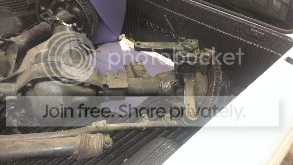

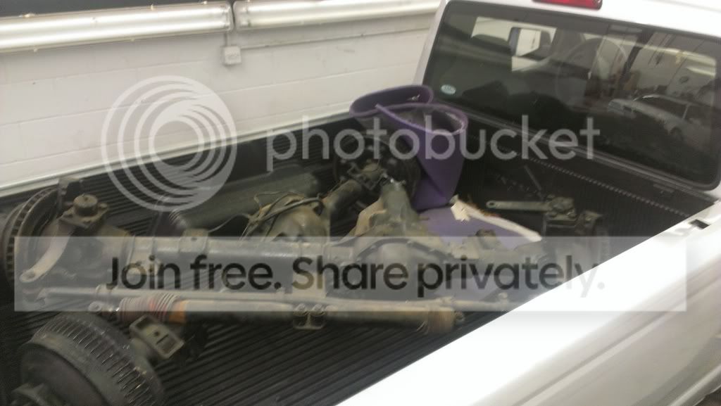

picked up these axles over the weekend took a chance on the ford front.

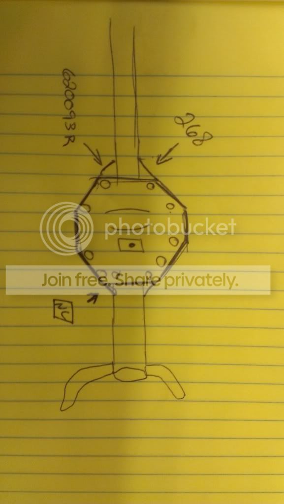

how can I tell what it is, I know its a high pinion 60, the id tag was taken off the cover, its say 268 on top corner of the pumkin and 620093r.
ive tried imputing the bom into the dana 60 site with no luck, and cant seem to find any numbers on the tube.
here are some pics any help would be greatly appreciated.
If original, the date stamp on the ring gear will give you an approx year. You can also measure the spring perch width to identify if its per '80 or post '85.
My guess based on the steering arm is its an early model.
