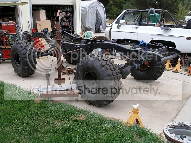

Here's a couple pics after work today. Working on fitting 73+ lift springs on the 1st gen chassis, shapped a cpl shots after working on the new front spring hangers today...

Pics here are of the mock-up. Gonna try it with 8" springs (shown), zero rates in rear, 1" body lift. BBC will be shifted forward 2" for clearance. On board air, etc etc...

looks awesome. Are you using regular 47" front lift springs for a 73+ or did you go 52s or something?
Yea the front springs were ordered for the 73, 47". Fabbed the front/front hangers.
the front hangers are in third pic

Hey,
I was wondering if you could shoot a closer pic of the front spring mount you made?
I'm putting 1/2 ton springs up front on my 68. just running to the parts store now for bolts to get the rest of the rear brackets on (truck rear spring front hanger, and a 2nd gen flip with cherokee lift shackles, 4" 56's and a 3" block)
you may wonder how this ties in and is not a toal hi jack. the front spring front hanger and rear blocks came from greg, k5monsterchev's k5 as well. the rest of his lift is on my roommates 72.

So its you that got those spring hangers! lol I was sorta wondering where they'd gone (not that I expected them on the parts I bought). Turns out those little buggers seem to be hard to find (:D) so I/we decided to just make some new ones. Had my father design and fab em up, think they are gonna turn out nice. He even put some adjustment holes in them in case I need to move stuff up/down/around.
Right now the hangers are just tacked together. Im on a 2-3 week trip so finishing them up will have to wait until I get home. I'll be sure to post some better/closer pics then.
