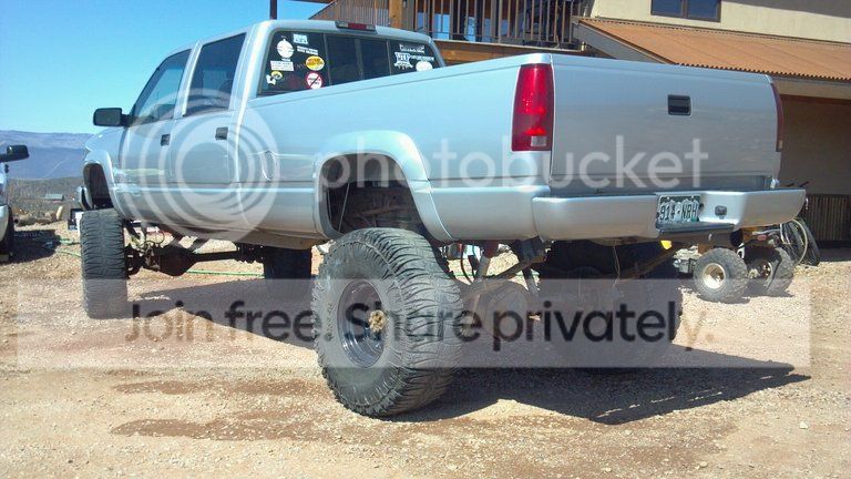

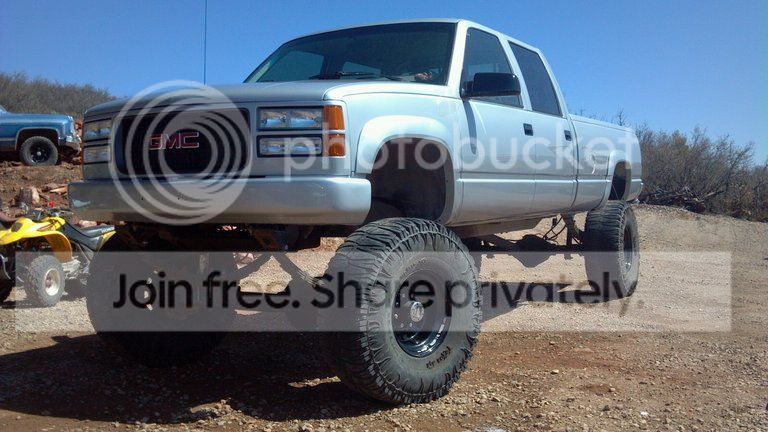

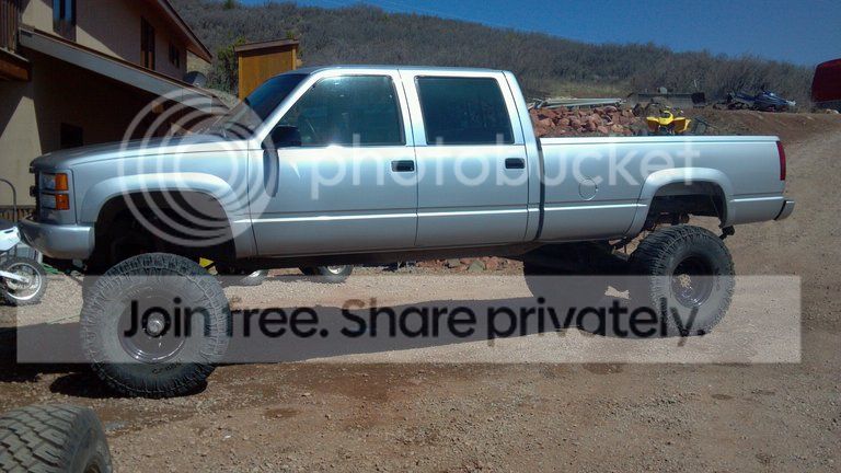

some pics of my SAS 94 GMC 1ton
kewl!!
lifted crew cabs are just flat out sex-ayy!! :waytogo::waytogo:
Here's some details on the 1 ton,High pinion D60 front axle from a 98 Ford 1ton ,GM 14 bolt rear and 4:10 gears,ORU solid axle mounts and crossover steering,12" superlift front springs,custom atlas rear springs,with a ORD zero rate leaf,shackle flip and 6 inch HD shackles,Front shaft is a high angle Tom Wood item,rear shaft is stock with a modified center carrier crossmember,2005 cummins 6bt 12V for power running a dodge diesel NV4500 with the tailshaft swapped out for a GM shaft,the Xfercase is the original that came with the truck,tires are truxus sts radials in the 38" variety on El cheapo black 16.5 rims.
