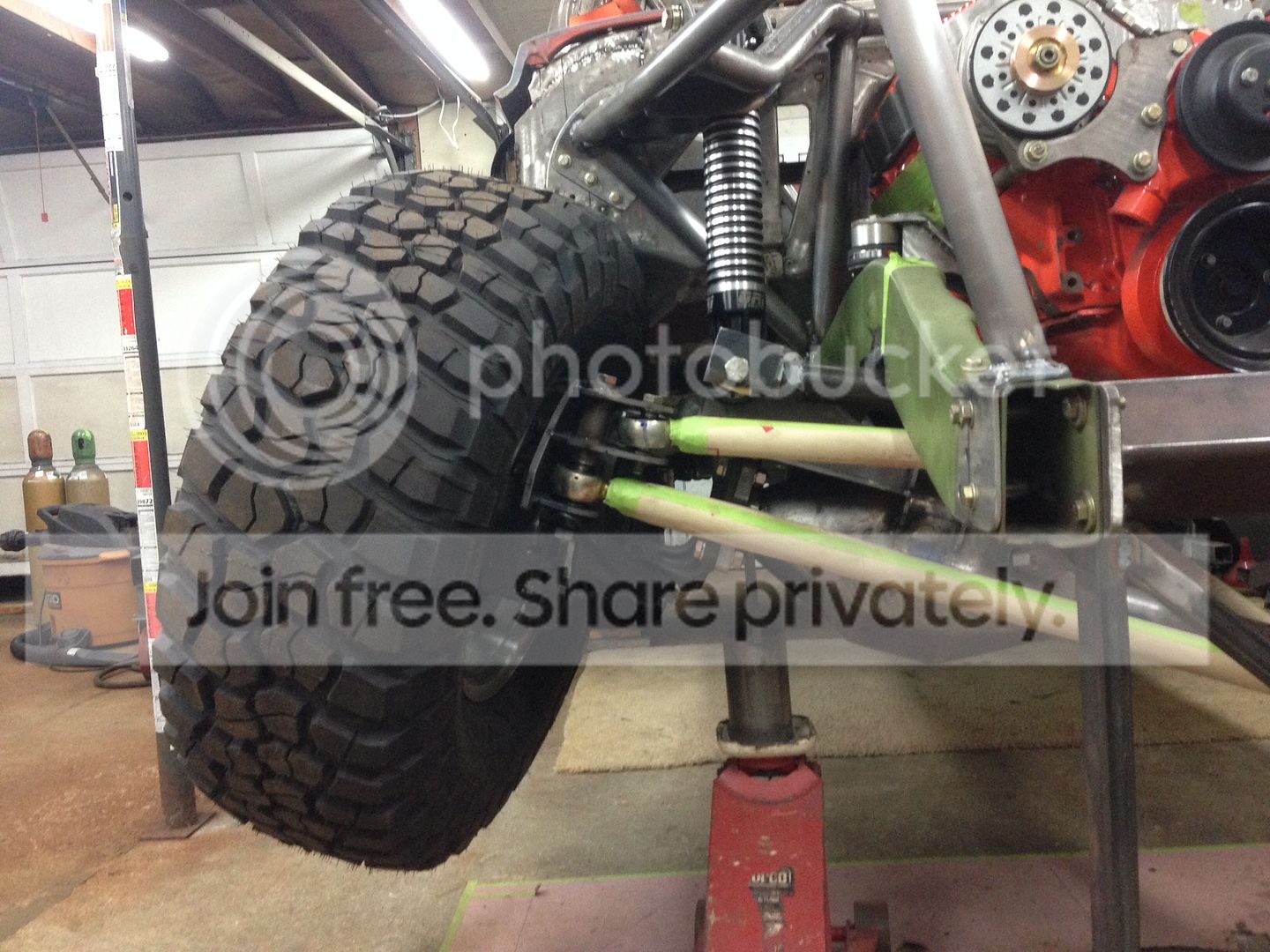

After an evening of experimentation it's pretty clear now that the tire won't be anywhere in the vicinity of that next tube I wanted to install.
This is PS "full bump" AND DS "full droop"|
Stand down everyone...... But thanks for the offers to help! :bow:
