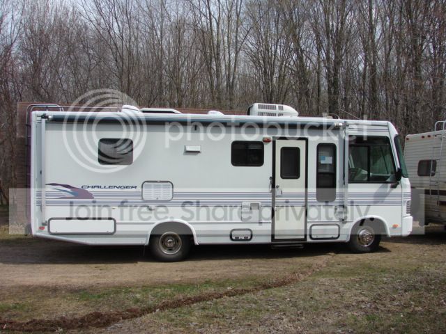

My motorhome is on a Chevy chassis. It has a 14 bolt rear axle with dual wheels. Currently there are 235 85R 16 tires on it. They are larger than stock but I would like to replace them with the same size. What is the minimum acceptable space between tires?

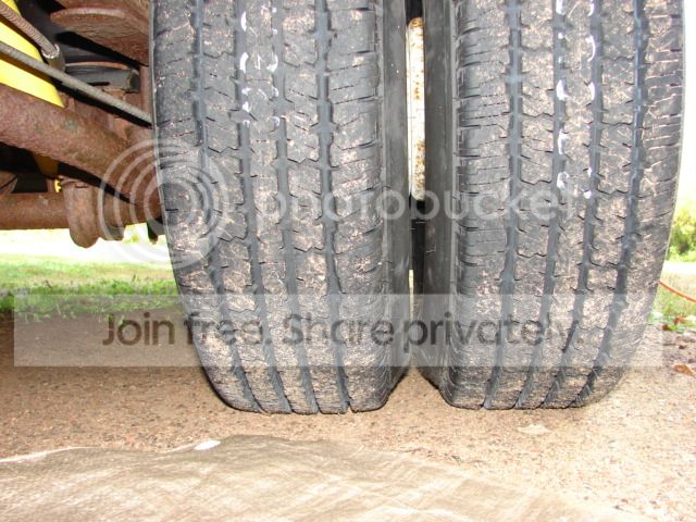

My new tires touch each other at the bulge. I am looking for feedback on my 2 options of adding a 1/2" spacer or adding a 1" adapter.

I installed a steel spacer between my RV's dual rear wheels to separate them so they would have adequate clearance.
Before, the wheels are touching.
Spacer installed on inner wheel.
Finished installation.
