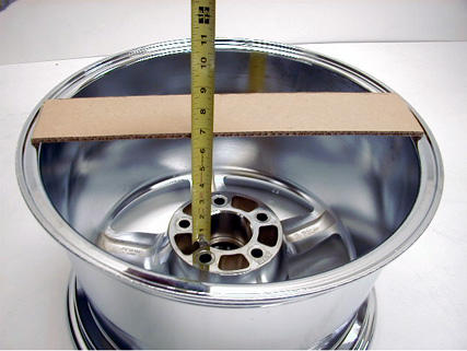

This is the measurement for backspacing
4.5" BS on a 9" wide wheel will be centered, or 0" offset. The more offset you get (like the 2.5" BS) will set the tires farther out, and depending on your tire size/fender clearance/etc you may hit the outside of the wheel arch under compression/turning.
I'm going to venture to say that the 4.5" backspacing is most likely going to be closer to what you have on the truck already than 2".
