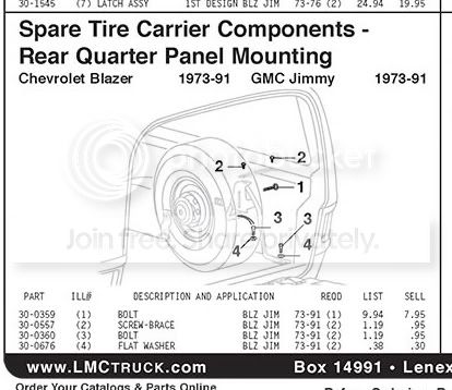

I'm a little late to the party, but this might help...
It's a little hard to see in this clip from the LMC catalog, but as already mentioned, the bar fits where you've got it.
meanboyjr that helps a lot thanks! I knew I had seen it somewhere before but the worst part is I couldn't find a single picture or diagram of it....until now. Thanks again.
